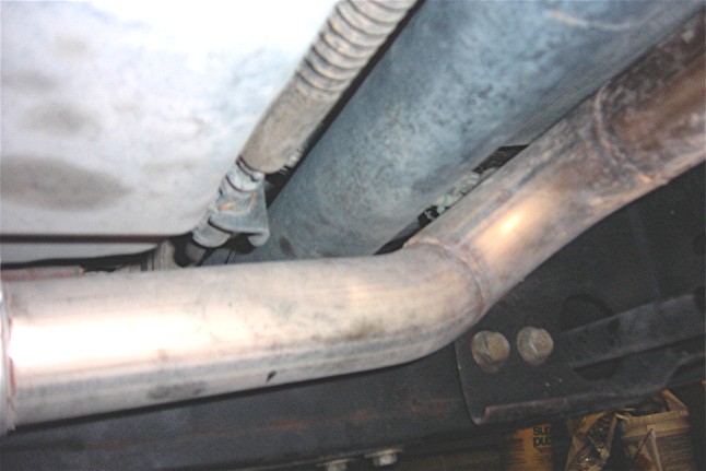

Here's a couple shots of my SW exhaust near the front driveshaft. Crossover point is near the crossmember.
Attached Thumbnails headers for a lowered 4wd 02 avalanche-picture-006.jpg   headers for a lowered 4wd 02 avalanche-picture-013.jpg

your drive shaft does not move in an ifs application. I am not aware of any 4ed kit that actually raises the front diff to correct angles, nor do I think you could do it, due to clearance with the oil pan. You should be the same as a stock truck. Any NBS headers and y pipe should work for that application.
