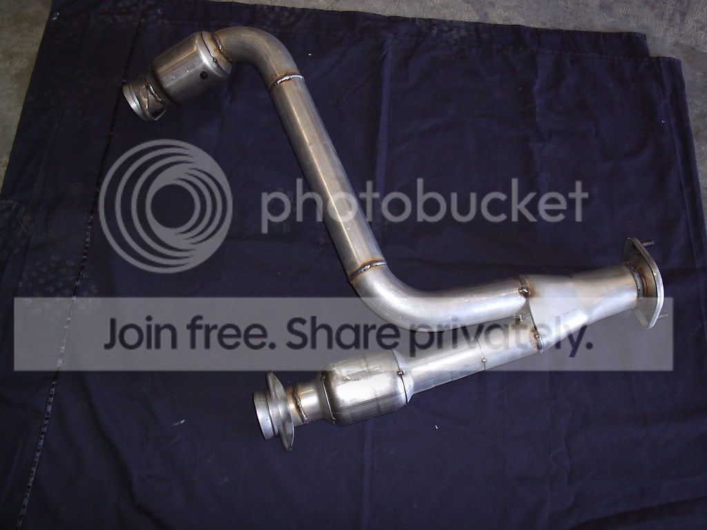

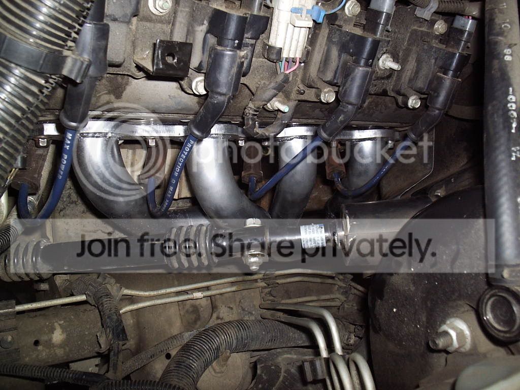

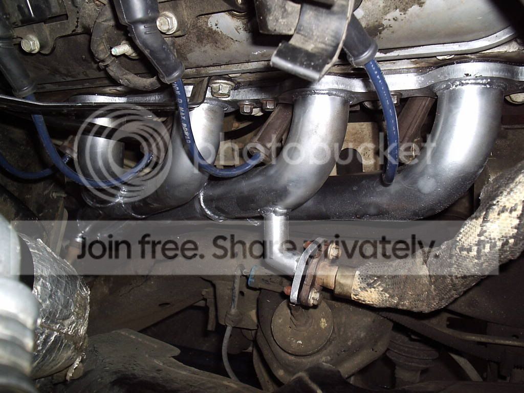

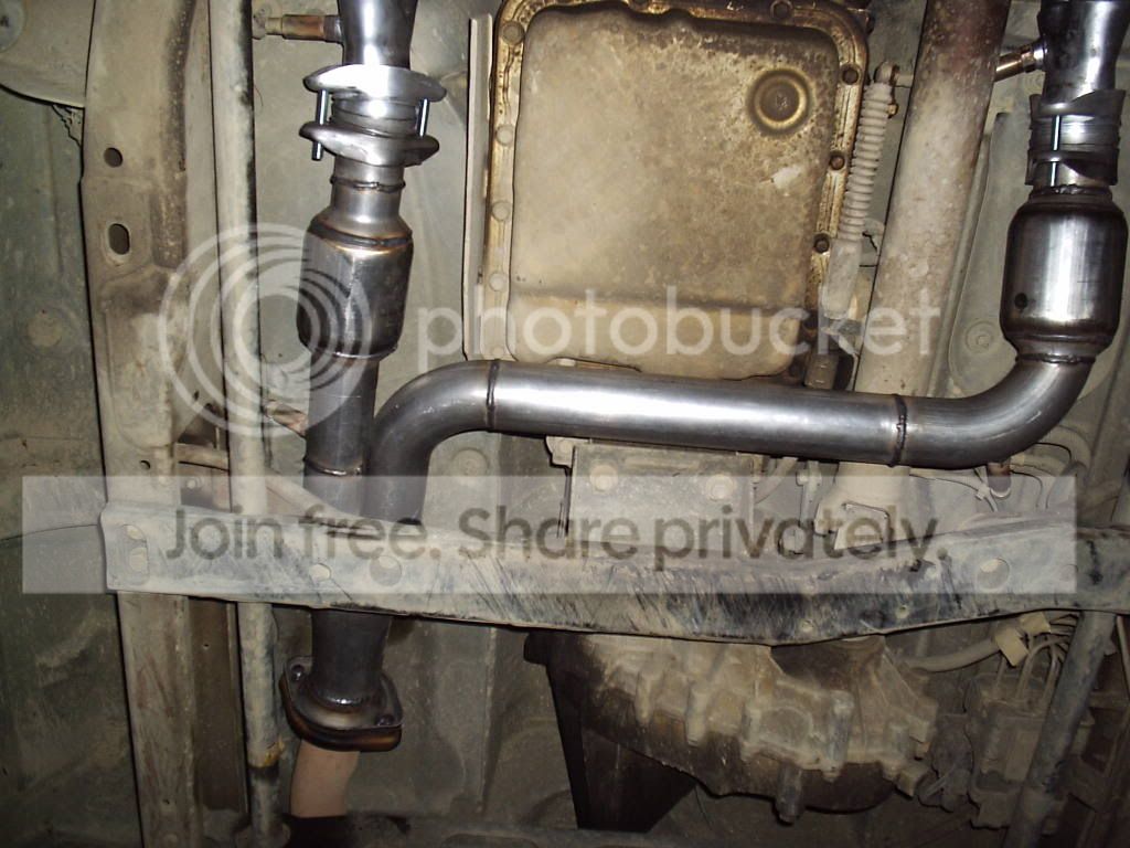

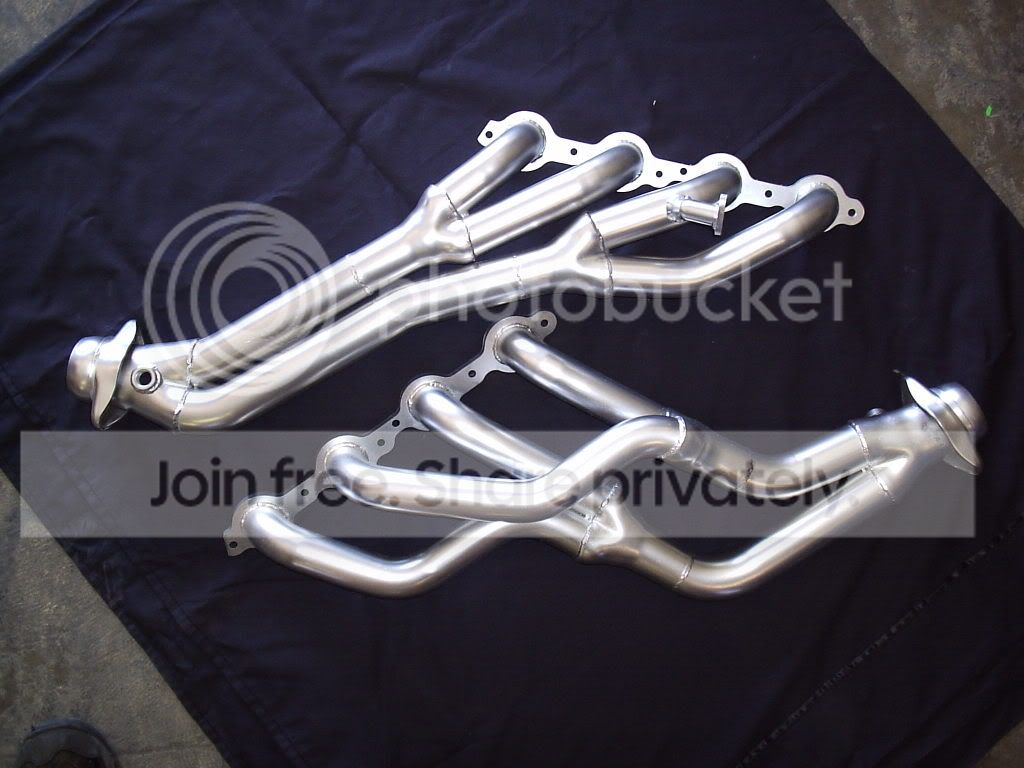

I know you guys on here are all into traditional headers and you all like the pacesetters and obx's and then there are the new lpp's but i found these and would like to know what you think. They are tri-y headers made by clear image automotive and they use all ball/socket flanges for a complete bolt on install and are available in 1 5/8 or 1 3/4 primarys and have 3/8 thick flanges and are 14guage tubing. I guess what I want to know is what the pros and cons to both styles is.

Tri-Y headers like the ones you posted are traditionally better for low to midrange while conventional longtubes free up more power in the upper RPM's. Theoretically, for a truck that craves low end torque, a tri-y header would be better suited.

WOW thats alot of money for them.. They are more suited for a low end, tq then all out flow... I wouldn't dump that kinda money on a header that isn't stainless...

I have to agree with the others who have posted. You should have good low end torque, just what you need for a daily driven truck, but the price does seem a bit high for the product. The Tri-Y header is a proven design that just never seemed to catch on. I would like to see some dyno numbers with this header.

Hate to sound redundant but the low end tq thing is what tri-ys are known for but im intrested in seeing some dyno numbers on these myself....
