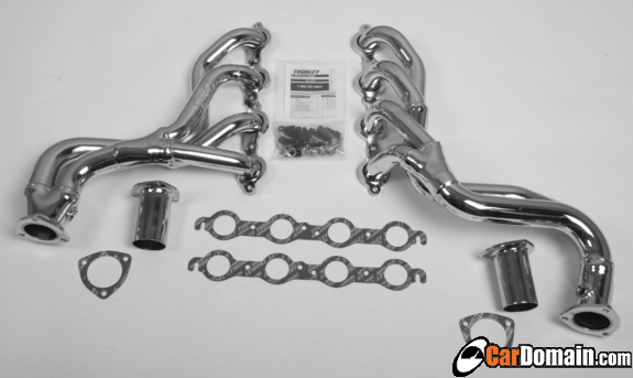

I beleive that these are Thorley headers for our engines
Thats them. Thorley 310Y-c. Thorley says they wont fit 02+ trucks but apparently they will. People with 03+ trucks areusing them. Ive been looking into it!!

Why not look more at the Thorley Tri-Y LT?? Hell of alot cheaper and still a good header. The Belangers just have a bigger primary, collector and different O2 sensor placement.
