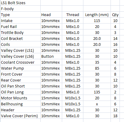

M8 x 1.25, maximum drill depth is 16mm so add the thickness of your flange and that should give you an idea of how long the bolt needs to be..

Sweet!!! You guys rock this helps a lot, if anyone has more info have at it!!
