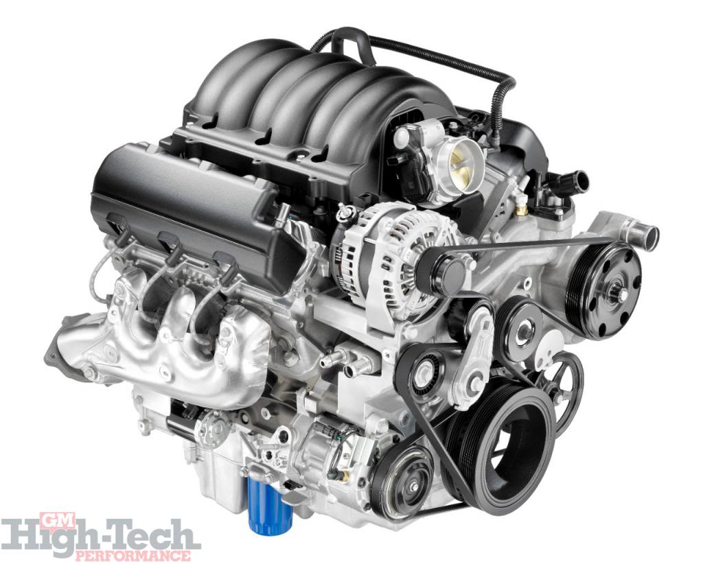

Originally Posted by xx_ED_xx
I think some of these guesses are high, I remember seeing the coil packed 4.3 back in 08. did the 4.3 get a redesign or?
The 4.3 got redesigned for 2014 as the 4.3 LV3.
The 4.3 never got CNP or COP until 2014. The LU3 of 2007-2013 used 3 coils where the distributer is placed.
Previous to 1996-2007 the LU3/L35 used the single coil with distributer in GMT400/800 trucks..
2014 LV3 DI/CNP

As i stated coil packed 4.3 and since you stated the years that makes sense. nice to see they are revising it will it be direct injected? looks like an upgrade of the 60 degree 2.8 3.1 3.4 family

OK you said you say a coil packed 4.3 in 2008, with the long wires I assume? yes thats OEM.
Is it direct injected?
As I stated 2014 LV3 DI/CNP. So yes, it will be Direct Injection with Coil Near Plug ignition and still a 90º block with 4.4" bore spacing, just like the L35/LU3 etc.
GM is dyno testing a direct injected twin turbo V6. Expect to see that out on the next couple years. A prelude to the extinction of the V8 engine. I wish they would go super small displacement V8 so at least the engine could sound good. Unmuffled V6's sound like *** IMO.
