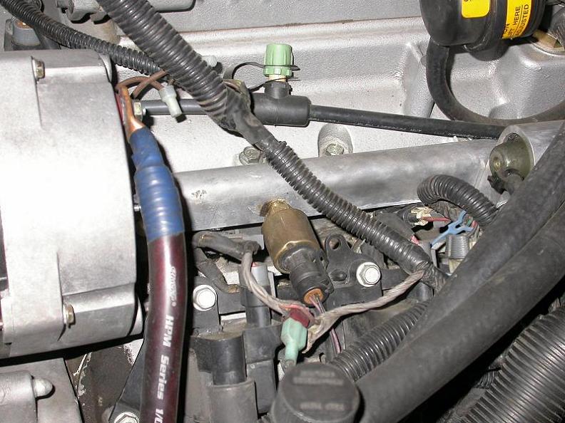

Here be mine, I didn't use an adapter, just screwed directly into the Radix fuel rail. Has work great for over a year. I had a rag ready when I did mine, but if you let the truck sit for awhile the pressure should bleed off on it's own. I got very little leakage, much less than I was expecting. Mine is Autometer also, so unless they changed their senders yours should work exactly the same. This is on the driver side, not the passenger, near the front of the rail. There was a little cap there that I removed, same thread as the sender. Very simple.
