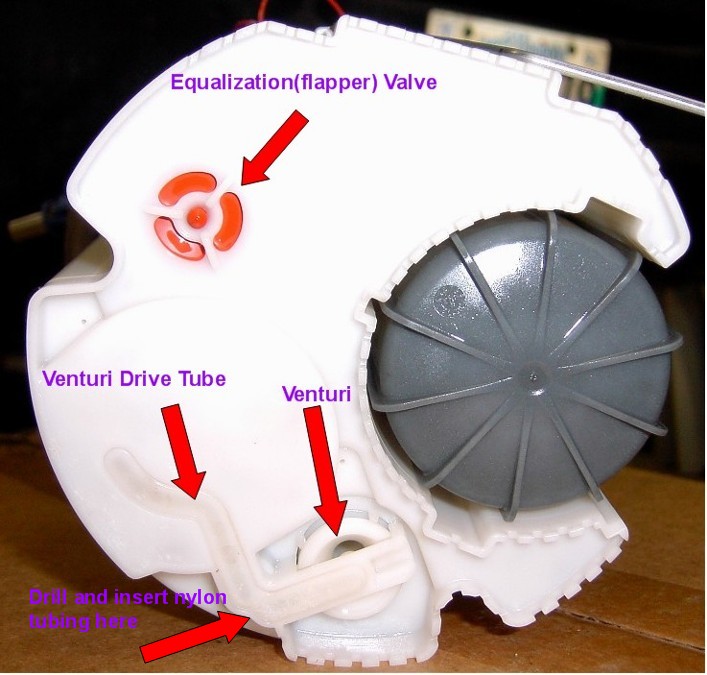

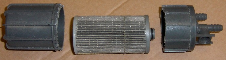

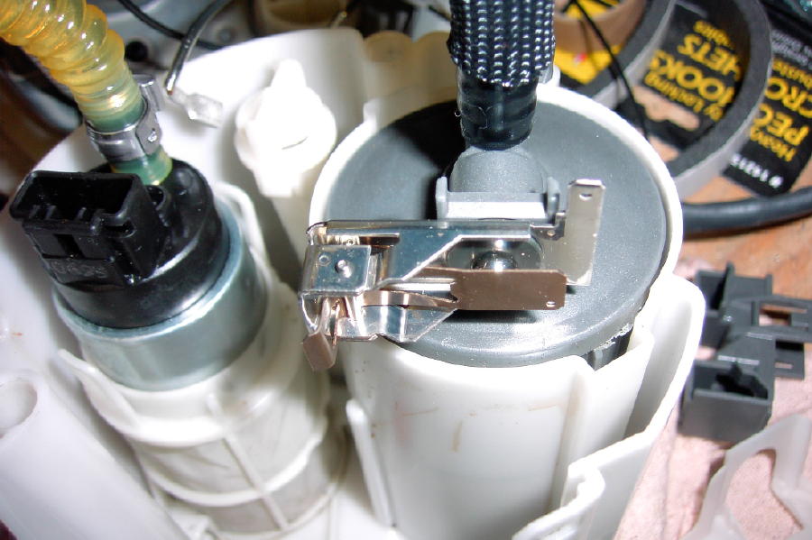

You can buy aftermarket socks for those modules that have a separate sock prefilter on the pump. The actual filter on the 04+ trucks is a plastic or metal canister that is in the tank module along with the pump. Here are some pics of my module. The filter is the grey piece with the regulator on it. I cut open the filter.
