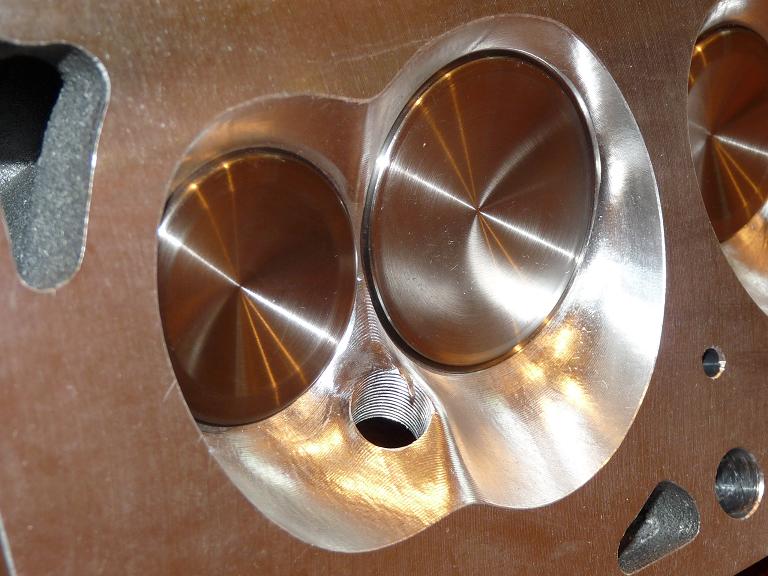

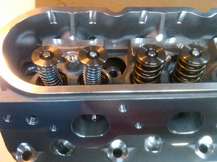

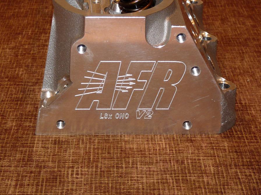

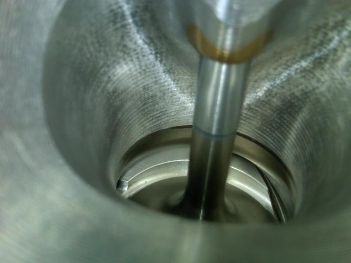

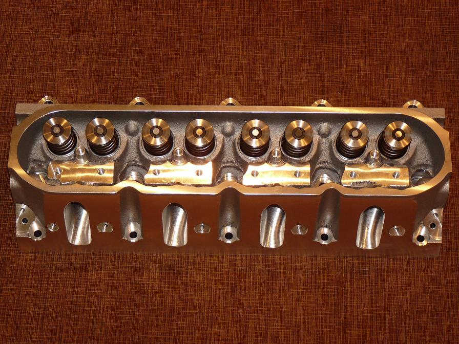

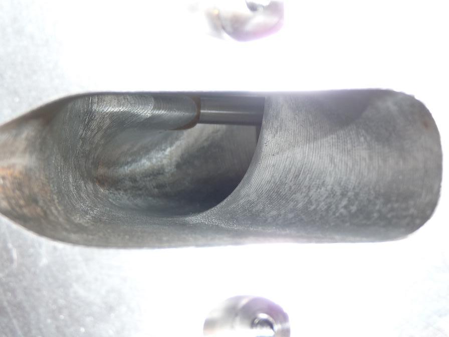

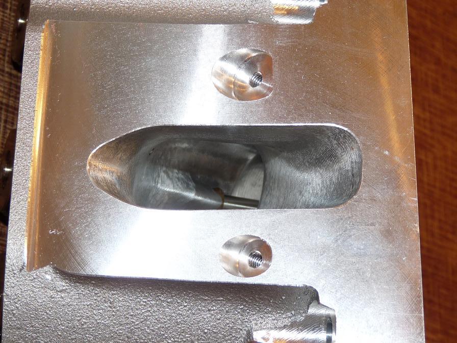

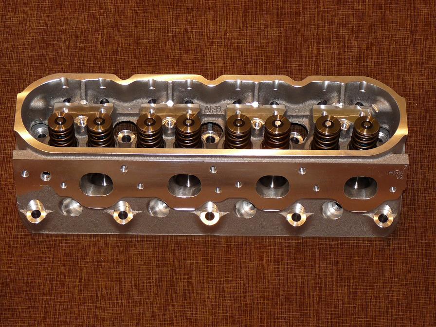

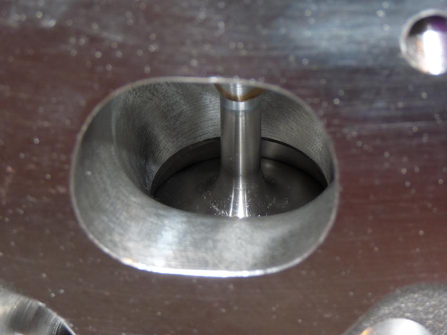

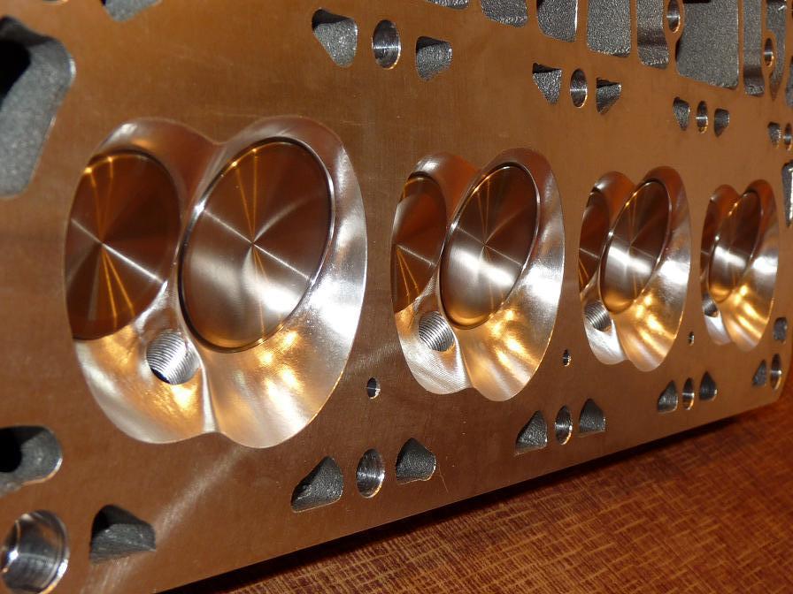

Here are the heads!

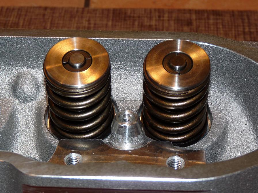

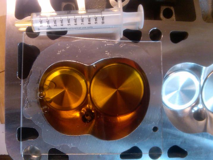

Checking to ensure correct combustion chamber volume, 63cc spot on.

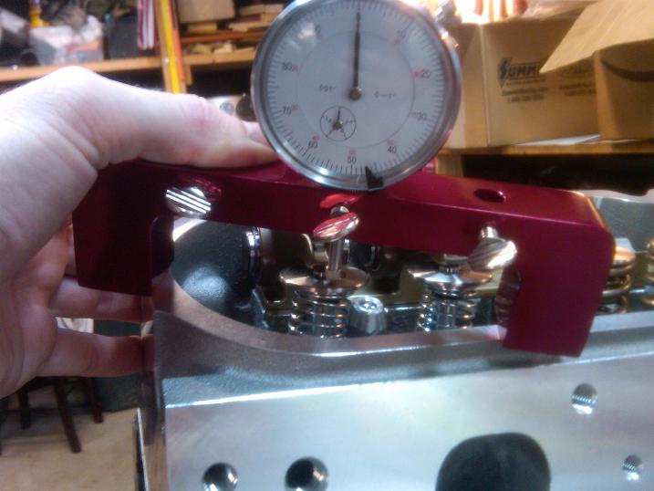

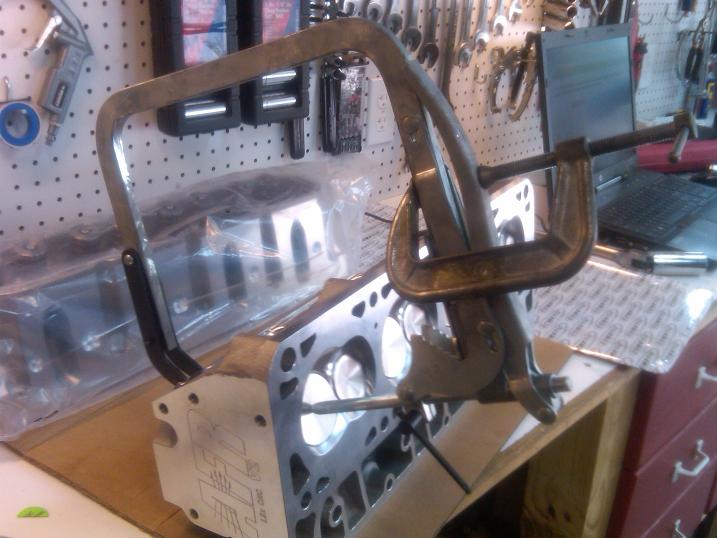

Removing springs for checking PtV. I needed a little help with the valve spring tool for the last click...

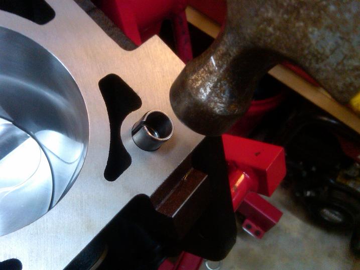

New head dowels installed with light tapping.

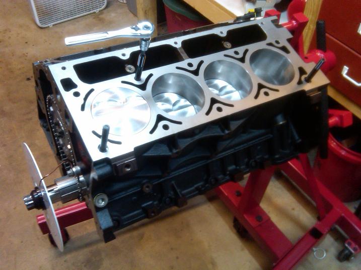

3 studs installed for PtV checking.
View of exhaust valve interfacing with piston relief.

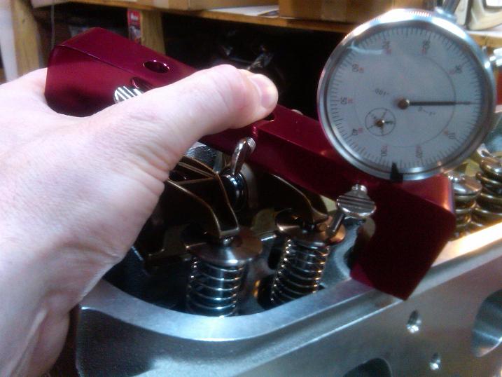

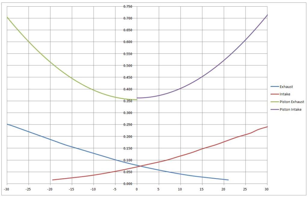

Measuring PtV. Although this magnetic bridge stand will obviously not hold to the heads, I used firm pressure from my hand to hold it down while I cycled the rocker arm with my other hand. I was able to get repeatable measurements.
Minimum PtV Intake = 0.272" @ 6.5 deg ATDC
Minimum PtV Exhaust = 0.258" @ 7.5 deg BTDC
The above numbers matched my calculated predictions based on measurements of the components prior to install. This chart shows piston valve relief surface position & valve tip position vs TDC.

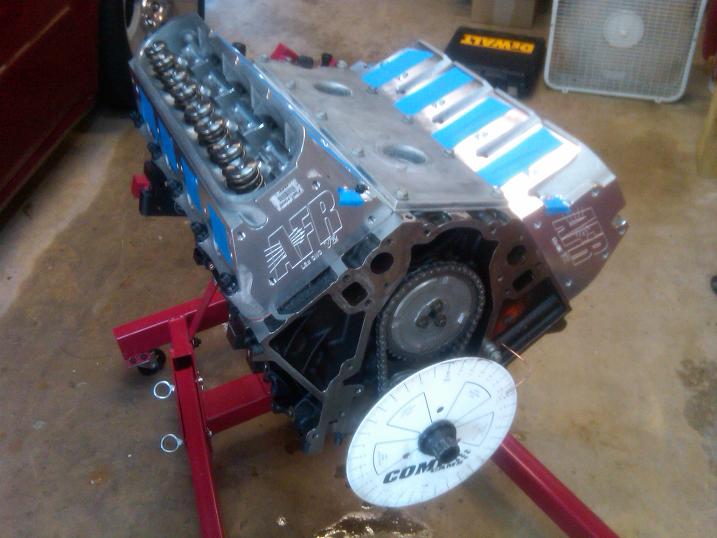

Starting to look like an engine again!

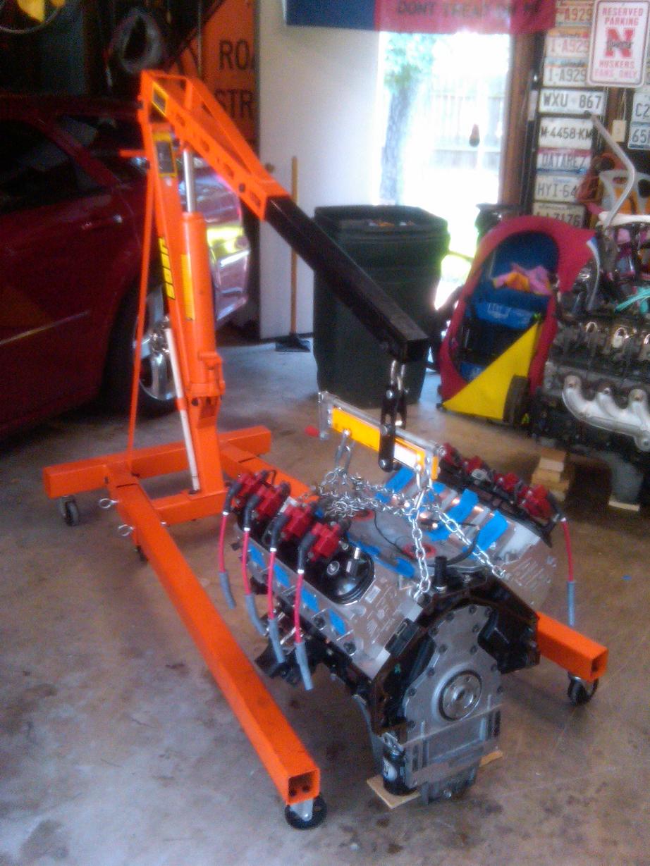

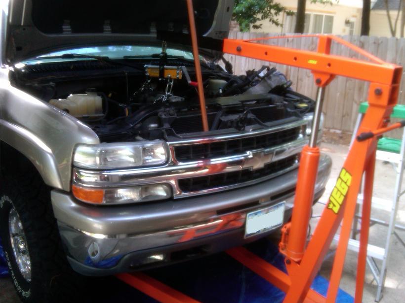

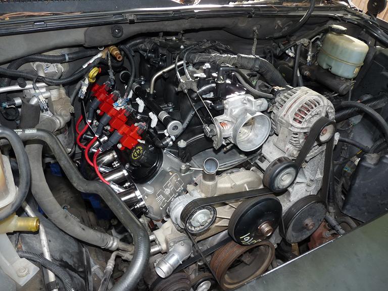

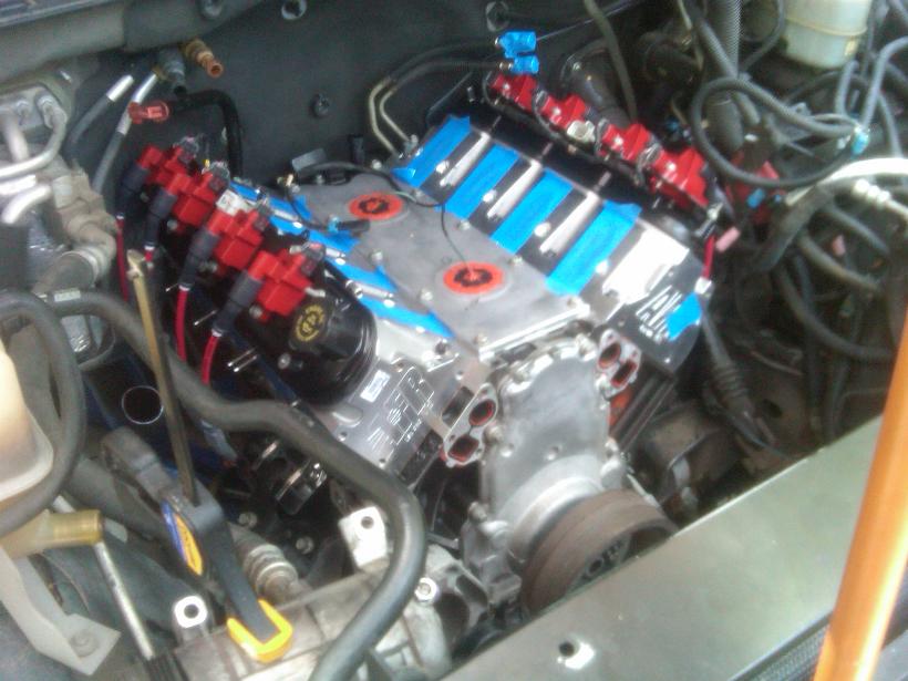

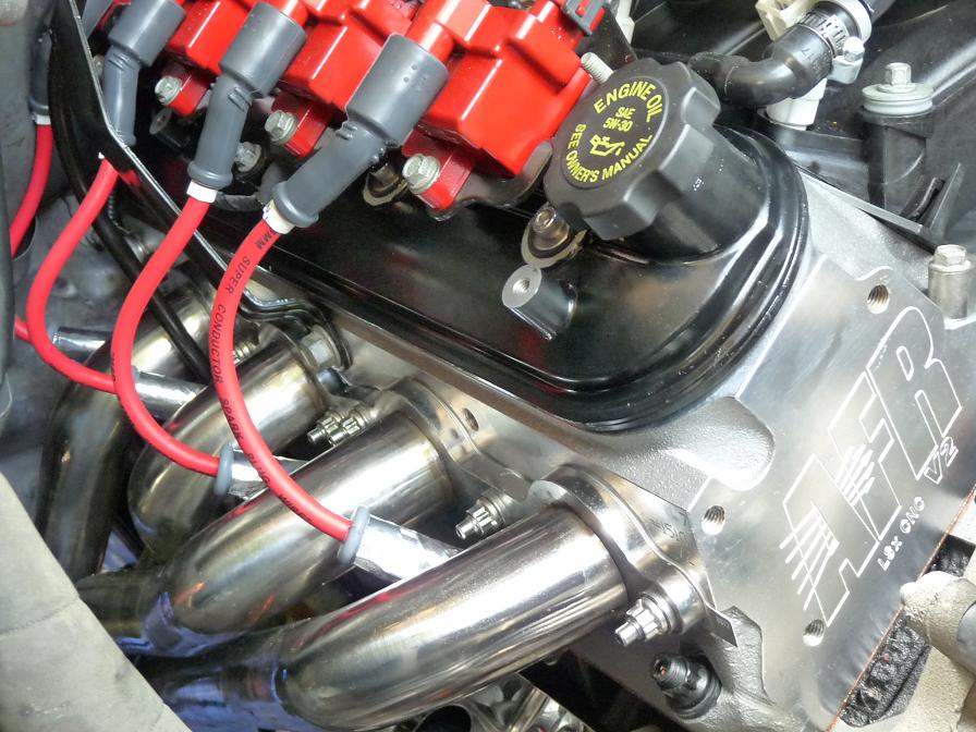

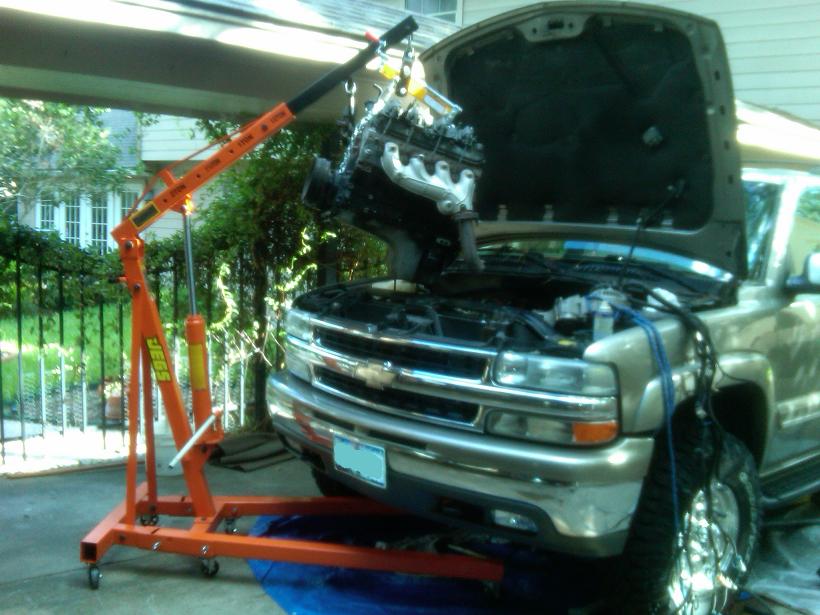

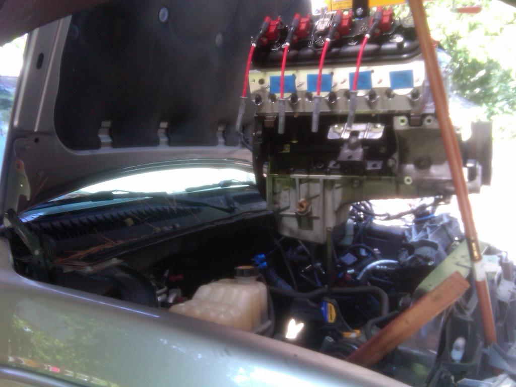

Pictures of the swap!
LQ4 coming out:

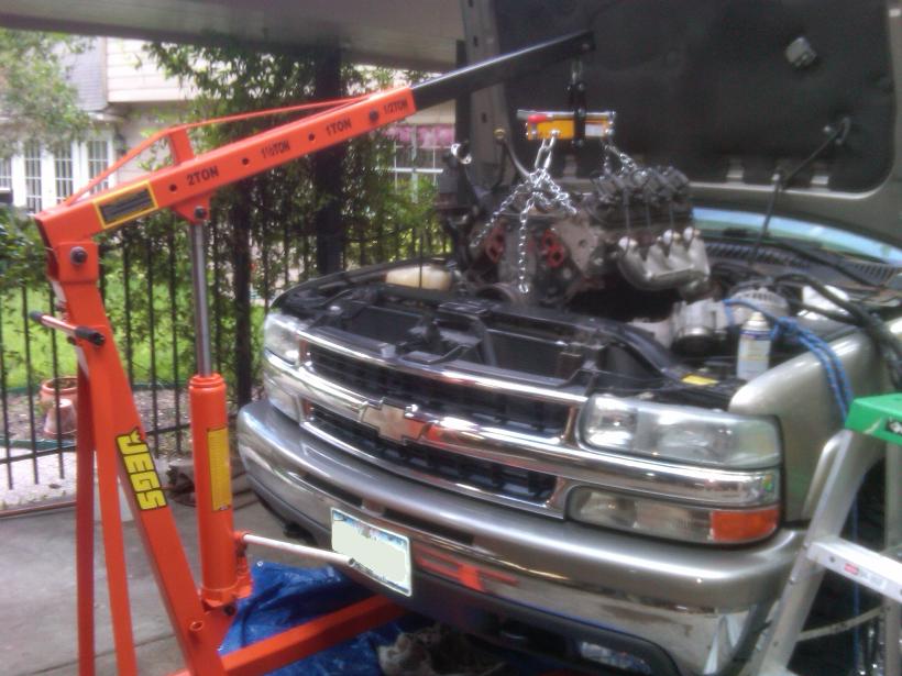

Setting up 4-point chain rigging on new engine.

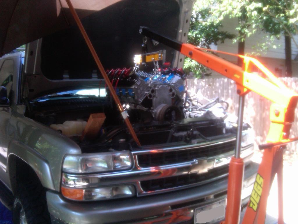

Installing new engine.
^ that's RTV on the knock sensor outer grommets, to help them seal out fluids (moisture, oil leaks, etc.)
^ Still have the factory intake for a few months. Going to upgrade to a Tony M fast lsxrt ASAP.

thanks for the replies.
Power is much improved over the stock LQ4, however the stock intake and TB is really holding it back. I'm upgrading those ASAP.
