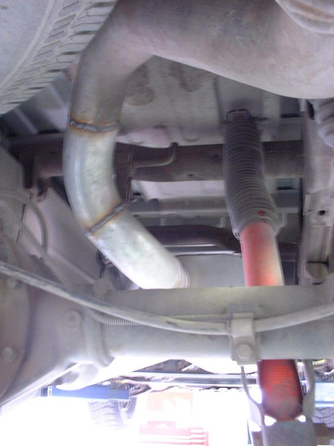

had the dynatech cats, flopro x pipe and flopro 2503 all welded on today. took the shop 5hrs. wtf? $350 later, it sounds cool. nice rumble. i think most of the noise is coming from the cats though. the muffler sounds pretty quiet. it turns out my cats were fine, not fried like steve at whipple guaranteed me they would be. what a ********.
The OE HD cats are badass cats.Take a pic of them and post them up in the F/S section. 5Hrs? WTF My flopro was $175 installed using a mandrel bend going out and flanged in the front.Your truck should sound great and no drone.
