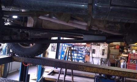

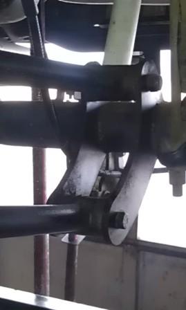

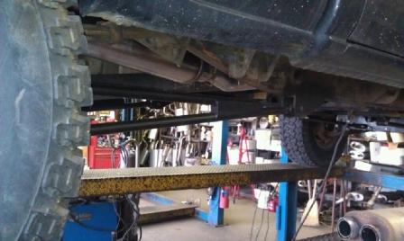

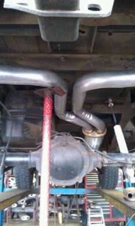

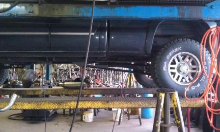

I did a few upgrades, I added a Magnaflow 12398 and ran my 3 inch pipe single in dual out. I also bent my pipe to accommodate the rear dual shocks in the future. I also snapped a few pictures of the ladder bars I building. I still need to add the cross braces but looking good so far.
I bought axel brackets online as a kit. rest was formed and welded.
I tried to keep bottom pipe with drive shaft angle
Ugly but not bad for not ever doing exhaust in my life.

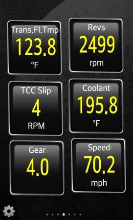

This was 15 minutes in traffic then 10 minutes on the hyw @ 70mph. 40 degrees out.
