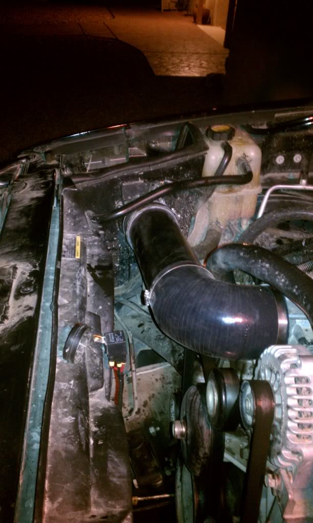

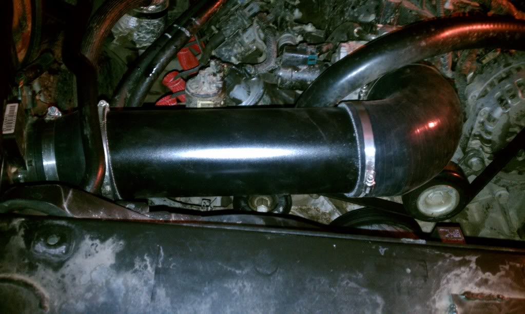

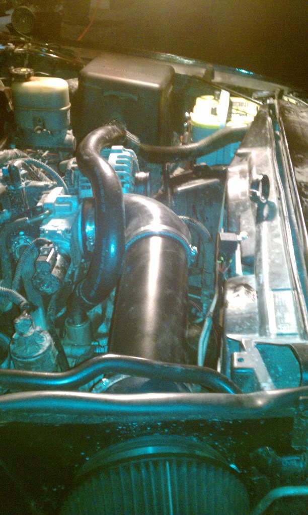

got it. cut about 1" off from the thermostat side and had to twist the hose to where it came almost straight up. I used a 4" 90* and a 4" to 3.5" reducer. also got a 2' piece of 4" exhaust pipe and cut to size. rattle canned with gloss black.

I know the engine bay is filthy, but that sand/mud is near impossible to get off once it dries.

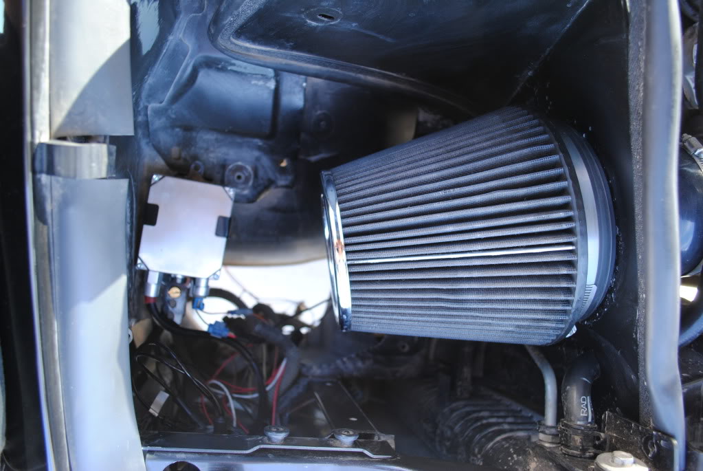

here is a pic of how "open" my filter area is
I still have the metal plate that goes there so when I go off-roading and there is a slight chance of water, I can throw it back in.
