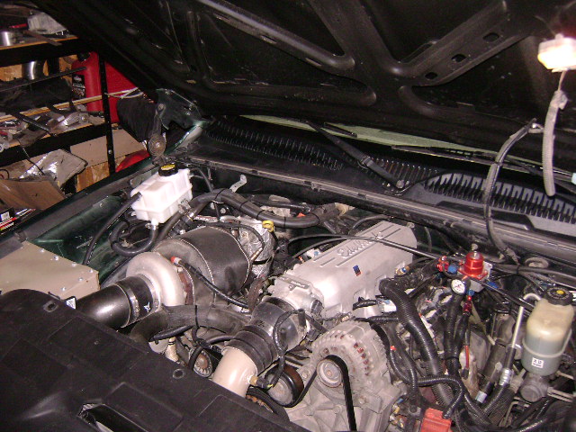

Before I swapped the motor and turbo kit into my 01 GMC. I installed the Pro-Flo and an 01 ZO6 cam into my stock 168k mile longblock. With the cam and using the stock intake/tb compared to the Pro-Flo and Edelbrock 90mmtb there was a 14hp gain from 3900rpm up. Low end did suck, but it was a precursor test with a 168k mile longblock and stock exhaust. I really like the Edelbrock, but the Holley is more versatile with the interchangeable tops and porting ease. My Corvette is getting swapped to twin turbo and I'll probably try and use the Pro-Flo on it.
current setup.
