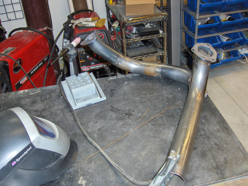

Originally Posted by timmer1
Hey guys,
but the driver side is a little more tricky to fab up without a bender.
Just buy some mandrel bent J-bends, cut them up and make your own if you have access to a welder.. That is what I did...
