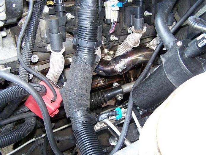

I'll take some pics over lunch. I have a new Kodak Z710 I need to try out.

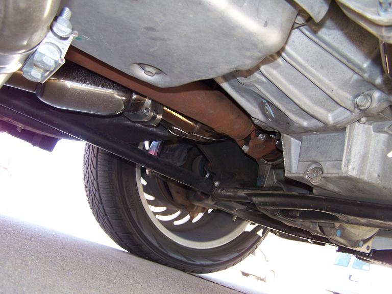

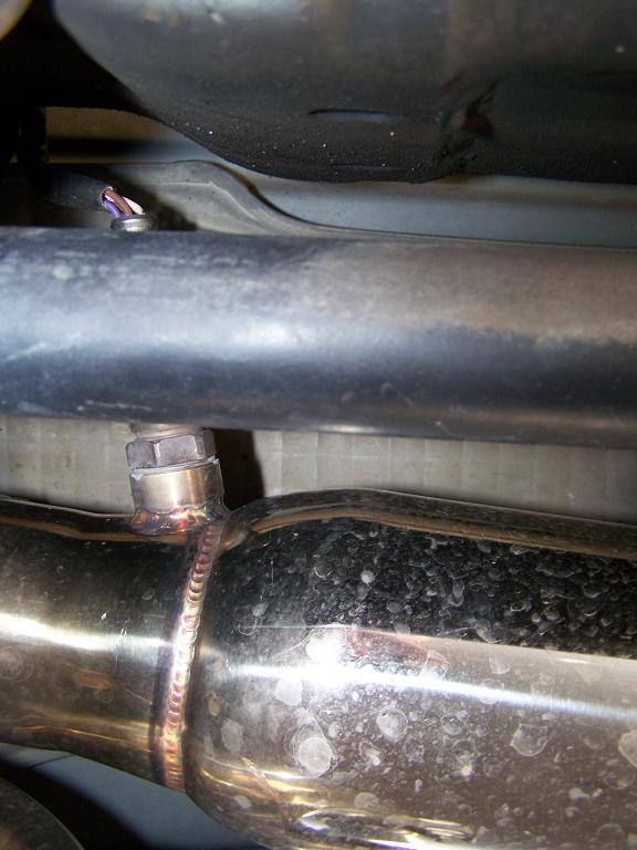

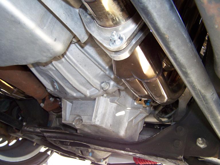

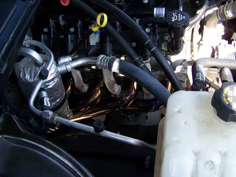

Best I can do in the parking lot at work. Shrunk down to 25% size for your viewing pleasure...

looks good, so basically add a set of sleeves for the spark plug wires and bold it up?

Yeah, they bolt right in for the HD, SS, and Hummer exhaust. The regular Silverado guys won't be able to mate up to their stock exhaust or a "stock fit" cat-back though (you guys have a Y-pipe and ours is duals to behind the muffler, then it merges together). The good news is that the OBX headers include slip fit joints, so just leave those off and you're stubbed out for custom true duals from there back!!! Not to mention they're stainless!!!
EDIT: Forgot to mention, the OBX lt's are basically the old design Dynatech's, so double or triple up the protection sleeves on the back two driver's side plug wires!!! I cooked those up on mine through just one sleeve.
