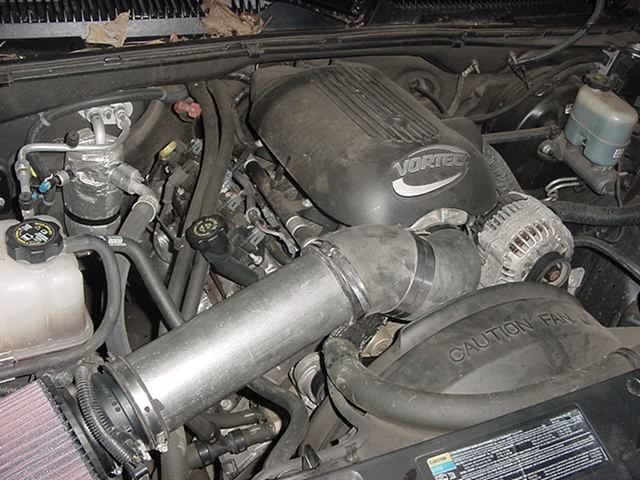

A friend of mine had some parts laying around at his shop. So I decided to make a cold air setup. Its a complete 4in system from the t/b to the huge k/n filter. Dont mind the dirty engine bay, but here are some pics....
Attached Thumbnails custom cold air for my new truck :)-mvc-027s.jpg

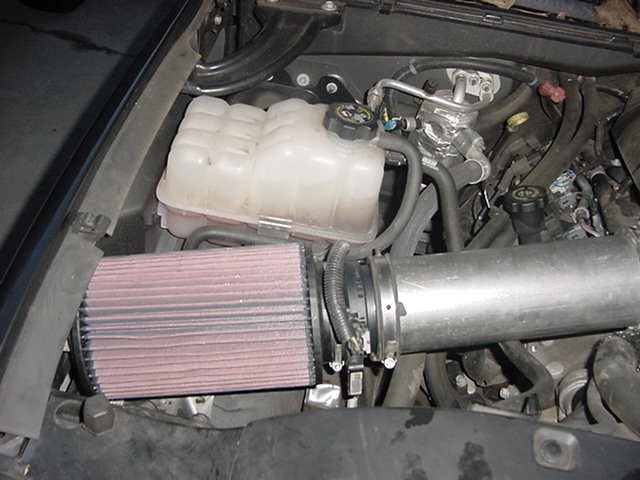

here are the other pics...
Attached Thumbnails custom cold air for my new truck :)-mvc-028s.jpg   custom cold air for my new truck :)-mvc-029s.jpg   custom cold air for my new truck :)-mvc-030s.jpg   custom cold air for my new truck :)-mvc-032s.jpg

Not too shabby. Looks good to me

thanks man. I noticed a nice difference with it. Part throttle is where it is most noticable and then again from 50 on up it pulls harder

nice work . im about to add a 90 degree elbow to the end of the maf and run 6 inchs of 4 inch piping down and attach the filter . get a colder air charge in there from inbetween the lights and bumper and form under the truck . remeber to remove tghe plate that was under your airbox to let air come up from under the truck

good setup. similar to mine. i could tell a part throttle difference also...

If it isn't too much trouble, can you list the sizes of all of the parts used?

its 2 90deg bent rubber elbows, and a piece of 4in aluminum tubing, and the k/n is the same one that fits a 98 checvy truck. part number is E-1796. you can get it at your local autozone or advanced auto parts.
I used a piece of the 4in tubing about 2in long to connect the 2 elbows together. the mass air meter fits perfectly in the end of the k/n then I cut a small piece of the rubber tubbing to connect the meter to the 4in tubing.

yeah I took the plate out. its nice an open to the bottom now

Thanks for the numbers man, I think I'll get started on this pretty soon. I think I'll try one of those cheap AutoZone colored cone filters instead of buying another K&N to see how they compare. They basically look the exact same thing to me..
