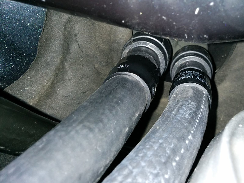

Then use the Gates PowerGrip SB heat shrink on the heater core nipples, block heater hose nipple.They did not have the other block heater hose/reservoir nipple clamp in stock. I'll do that one when I get really bored one day.

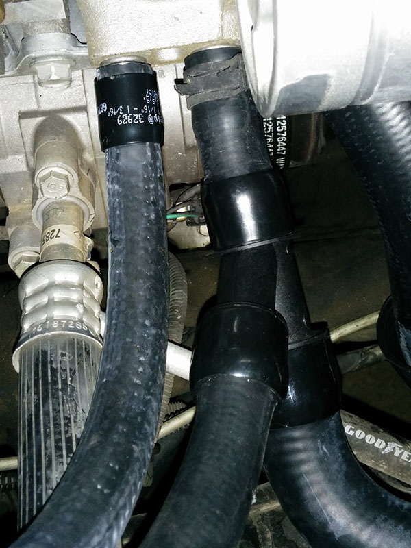

With the Radix supercharger in close proximity to the heater core couplings its very tight there and getting the special little split collar removal tool (Doorman 800-450) behind them was a real pain but doable. I replaced the couplings with (Doorman 800-409) units.
Getting the new couplers to pop on was almost as hard, I cheated with a micro amount of silicone lube on the nipple. To add to the frustration I could not hear them click on or feel the bump, but they are on fine. They just move onto the nipples slowly and stop.
Heat shrinking the hose to the couplers was nice and went on before going under the hood. I have a good heat gun.

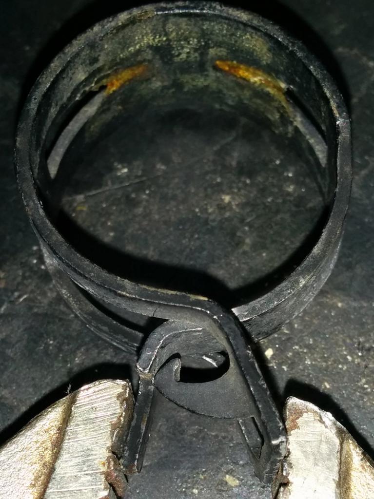

There is a barb on the water pump nipple creating a hump not allowing the clamp over it before pulling the hose off. GM's design for ease of assembly on the assembly line has a hook to hold the clamp open that is a one time deal without a special tool.
You have to compress the clamp, push it back against the water pump and pull the hose out from under it and off of the nipple. The problem is the clamp hits the water pump not sliding all the way off the hose giving you a good time to think up new four letter words and phrases.
The reverse is putting the clamp on first, slide the hose over the barb, and put the clamp on the hose. Its not fun either.
Sounds simple eh? NOT. This procedure was the same for the radiator connections also.
Why? These 2005 factory hose clamps are impressively made thick and have a pretty darned stout spring rate.
When you compress the spring there is a little hook that stops you from getting that last little bit you need to make it easy. This hook as I said before, holds the clamp open for an assembly line worker or robot.
Believe me, I am a machinist and industrial maintenance tech and I tried to take advantage of the hook but it didn't happen.
There are tools out there for compressing the clamps but not ones that will put the hook into play.
I carefully used vise grips to hold the clamps open against the hooks. I had to use a small set of pliers to turn the vice grip jaw adjuster to get it just right.

The Clamp Hook in a smaller version shown here on one of the water pump clamps I replaced with the Gates PowerGrip SB clamps
The heater Core Connections
The Water Pump Connections - The Y-Hose is a Gates as purchased with Gates factory installed PowerGrip SB clamps on the T.
