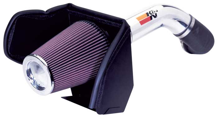

series 77 k&n intake

Okay, what I really meant is, open your hood and take a pic of your setup, so we can see how it is installed in your engine compartment.
