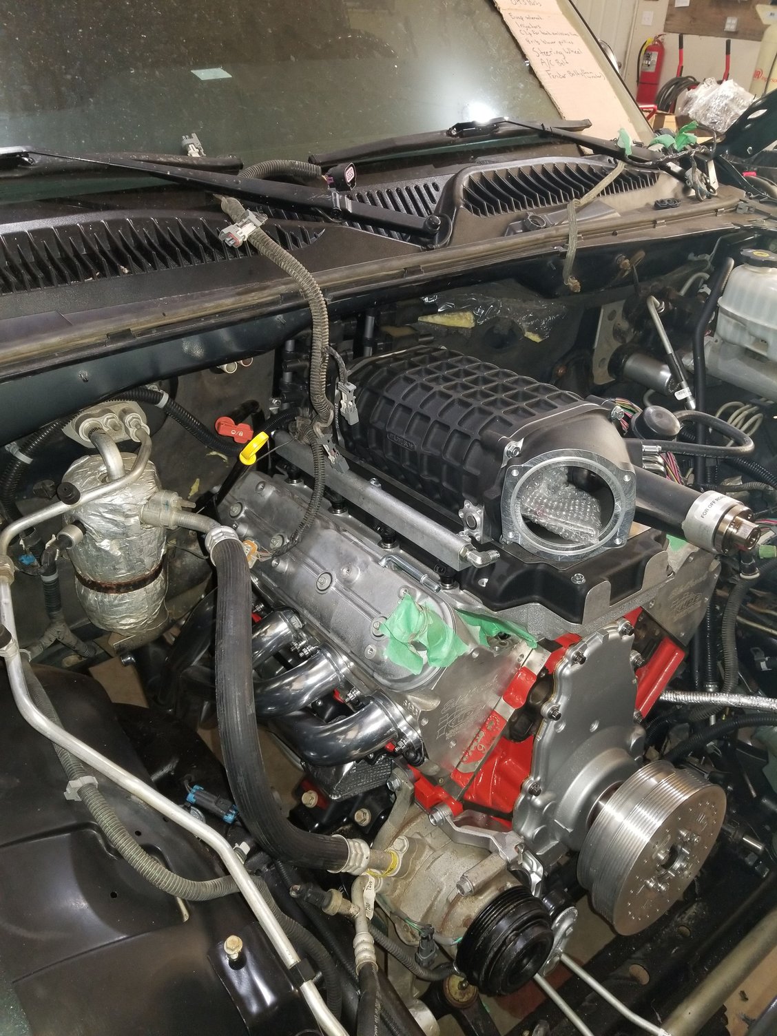

Passenger side needs to move up for fuel line clearance at the back of the rail but out of sight and out of mind.

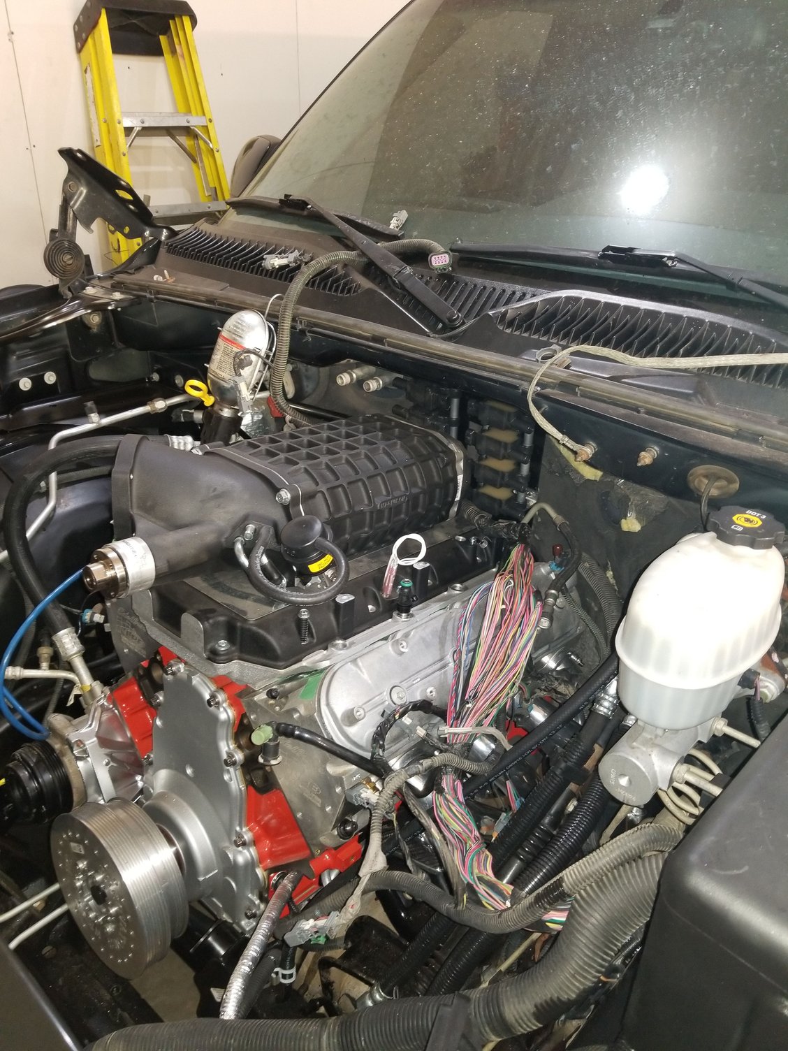

Just another for reference purposes.

I put mine on the frame rail under the truck and made little shields to protect them on all sides, had to make custom wires though. No, I dont have pics.

The goal with mine is I am running a set of tall powdercoated valve covers and don't want the wires hanging over them. Mission accomplished. Now I can run wires down each side and drop to each cylinder in the same fashion as an old small block or big block.

Kind of hard to see, but my driver side is down on the frame rail and the passenger side is up behind the coolant tank to keep them away from all the hot stuff happening on that side
Did you make those brackets? Very nice looking.
Old Mar 27, 2018 | 07:52 PM
1994Vmax's Avatar
Joined: Jan 2011
Posts: 1,636
Likes: 104
A friend of mine spent the day messing around building them haha. He used another engine and trans I have sitting as a mock up and then we tweaked it in the truck.

Is there any room on the firewall behind the engine? Has anyone gone this route? Looks tight back there.
