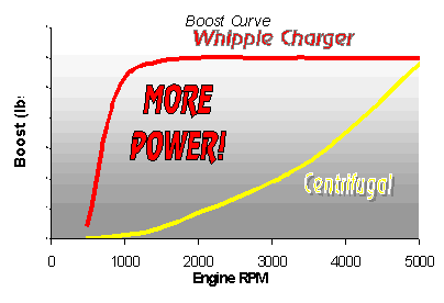

Magnuson Super Charger would be light years ahead of a cam/torque convertor. Since it's a positive displacement blower, it'll build low end boost quickly making it feel like a much larger engine.. As stated a centrifugal like Procharger needs rpm to build boost.

An LSA or Magnuson blower would give you strong low-end torque and more power across the board. If you're willing to wait and save, that route checks all the boxes: power, torque, and sound. For a 4.8, you'd probably want to go with a 1900 over a 2650. The smaller blower matches better with the engine's displacement and gives you great response without needing to spin it to the moon.
