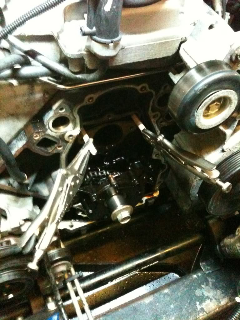

5/16" dowel with one side sanded, 1/4" dowels were too small in my case and wouldn't hold the lifters up.
I used vise grips to twist the dowels and hold the lifters in place.

Thanks for the correction, You are right it is 5/16 dowel rod and I believe it's the passenger side that the shaved dowel rod goes in. That's the side that seems to put up the biggest fight everytime.
