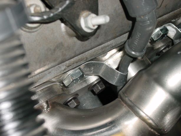

found this searching
Attached Thumbnails Burning plug wires with old style Dyntech headers-bracket_wire-5.jpg
Old Nov 6, 2008 | 07:32 AM
budhayes3's Avatar
PT's Slowest Truck
iTrader: (19)
Joined: Apr 2004
Posts: 17,863
From: Hackensack, NJ
^^^ That's the pic I was referring too...I like that idea best
