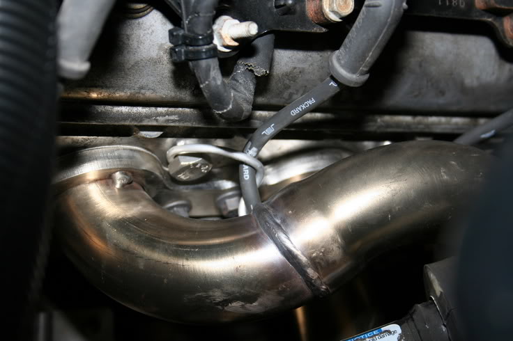

Here is what I did. Very similar to the other pic in this thread. I bolted a piece of thick aluminum wire to the engine and wrapped it around the plug wire to hold it off of the header. It's been like that for over two years now with out a problem.

very nice Robo! I gotta say though, the welds on my OBX are nicer than those dynatechs!
