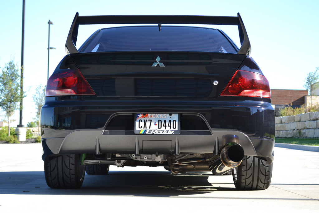

Yep, I miss that car
but it was easy because I had a company truck so I could do whatever I wanted and have it take as long as it took... Problem I have now is parking. Now that my girlfriend lives here, the other driveway spot is taken. My HOA doesn't allow parking in the street, but a lot of people do it anyway. I do not like shuffling cars around so there's a possibility that I locked the truck in the garage and drove the DD until it's done, then sell the DD if she runs good
