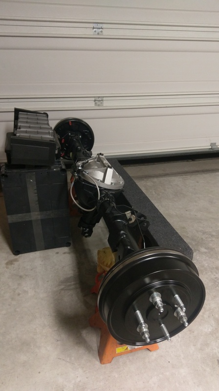

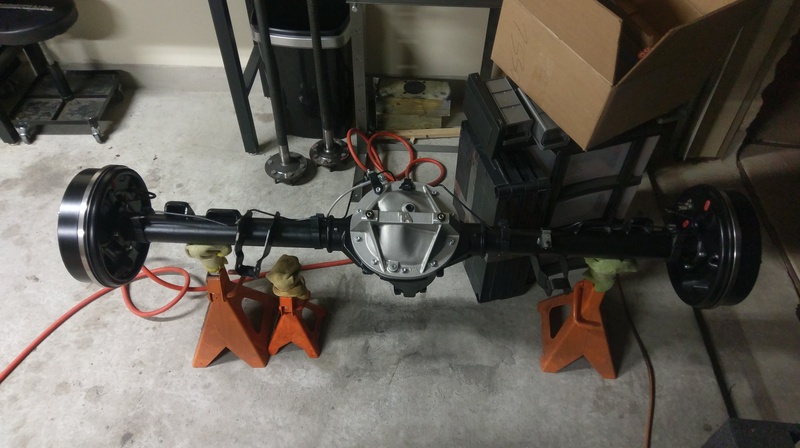

your thread was the one that made me want to do this actually. The way you cleaned everything up and painted it is what I like to do. I always end up going overboard, but if I set my mind small it stays reasonable. Also I don't plan to touch the rotating assembly. I know the factory engine is stout and I don't want to tamper with that. I also didn't plan to do head work, unless it was just swapping better OEM heads on. Getting them ported with new stems, seals, etc will get pricey and for a simple turbo DD I didn't want that cost.
I originally bought this extra axle to just do a 4.11/trutrac swap and it turned into a full build with all brand new parts
