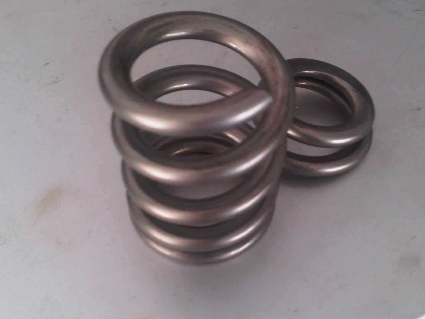

After 2 years and 30,000km (19,000 miles) one of the valve springs broke. Yes it was professionally installed and as far as customer service or a guarantee from Comp Cams-FORGET IT. 3 hours on the phone before you can even talk to someone!
Any recommendations for a different brand because they are all coming out.
Attached Thumbnails Broken Comp Cam Valve Spring-img-20120831-00506.jpg   Broken Comp Cam Valve Spring-img-20120831-00507.jpg   Broken Comp Cam Valve Spring-img-20120831-00508.jpg

Pictures not working, what series spring are they?

I bet 918. Get some pac springs.

Personally if they are Comp 918's I would get them out of there anyway. PAC's, Patriots etc. what are your cam specs as mentioned above?

It is in his sig... it is a GT2-3 (Lingenfelter) which, according to their site is a .571" / .578" lift.
I'd replace them with PAC 1218s (good to .600") or 1518s (good to .650") if beehives, but you may consider some patriot duals if you need to feel safe.

Like I said... GT2-3 is what his sig says and that is a moderate cam that is amazing for FI. I think Lingenfelter says you can run LS6 springs with it, but I'd use PAC 1218s as a minimum.

pac1218, pac1518 or psi ml1511s even better....
