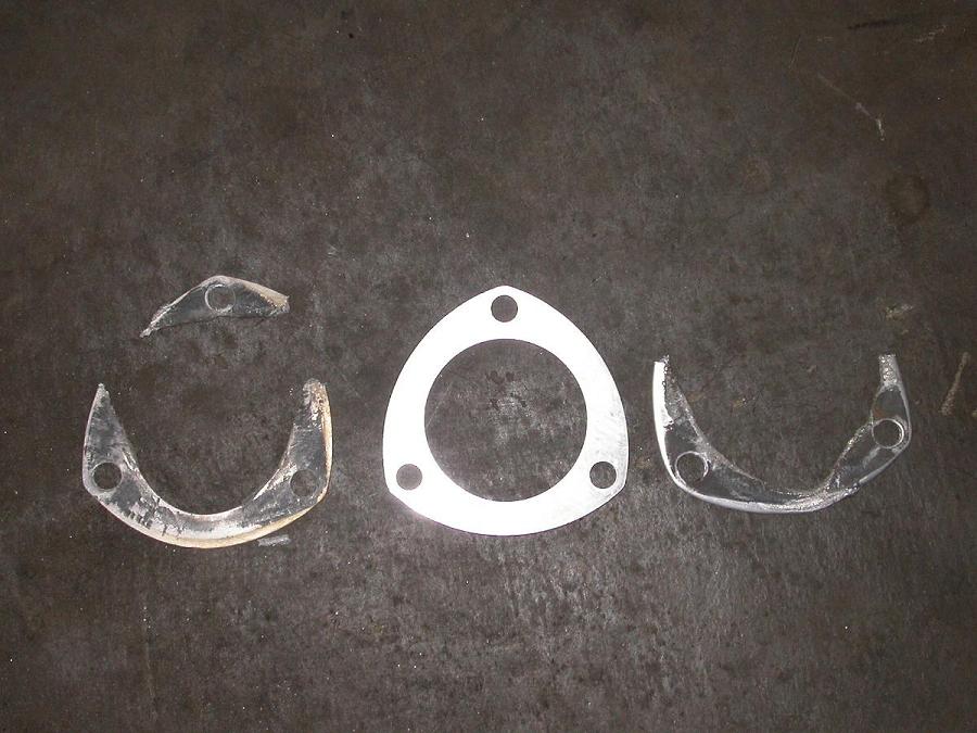

Anybody ever have this problem before? Been through two sets of paper gaskets and one set of aluminum gaskets now. They break and fall out, truck sounds like **** when it happens.

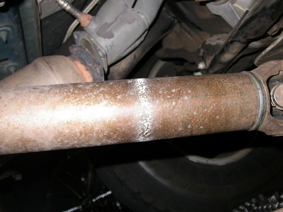

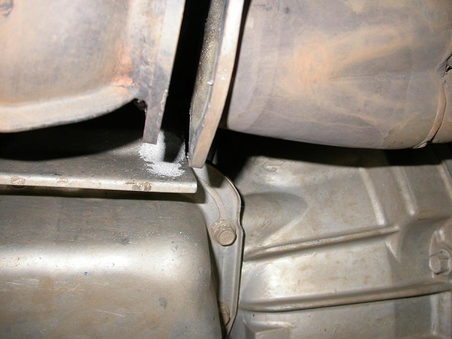

I just finished changing the gaskets. Here are some pics of what's left of the set that lasted one week exactly. It almost looks like they melted through and they sprayed metal particles all over the front driveshaft and tranny heat shield.

From what ive read that if your not useing the ball and socket flanges , the best gaskets are the copper gaskets .
You can pick them up from Summitt for about $10 bucks and they work great .
Thats what im useing and havent had any blow out yet !
Old Aug 18, 2005 | 06:40 AM
TurboGibbs's Avatar
Joined: Jul 2005
Posts: 5,257
From: Decatur, AL
I'm in agreement with the copper gaskets. I'd try those first. It is pretty obvious that the heat in front of the cats is higher than the melting point of aluminum. It would be very difficult to install those header buddies considering your flange is so close to the cat. Also make sure you have good lock nuts on those things. Don't use the ones with nylon in them obviously.
