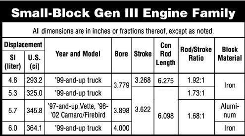

Originally Posted by SportSide 5.3
Gen III specs
Check that out Shandy.
Very different motors
I think that graph should look like this. I am pretty sure the 4.8 is the only LSx with the 6.275" rod, due to it's short stroke
HEY! thats weird. i believe your correct. thanks man

fandango you are right. the rods were one of the hardest parts to find bc they are not used in the other engines.
Gen III specs
Thanks...I printed it.
