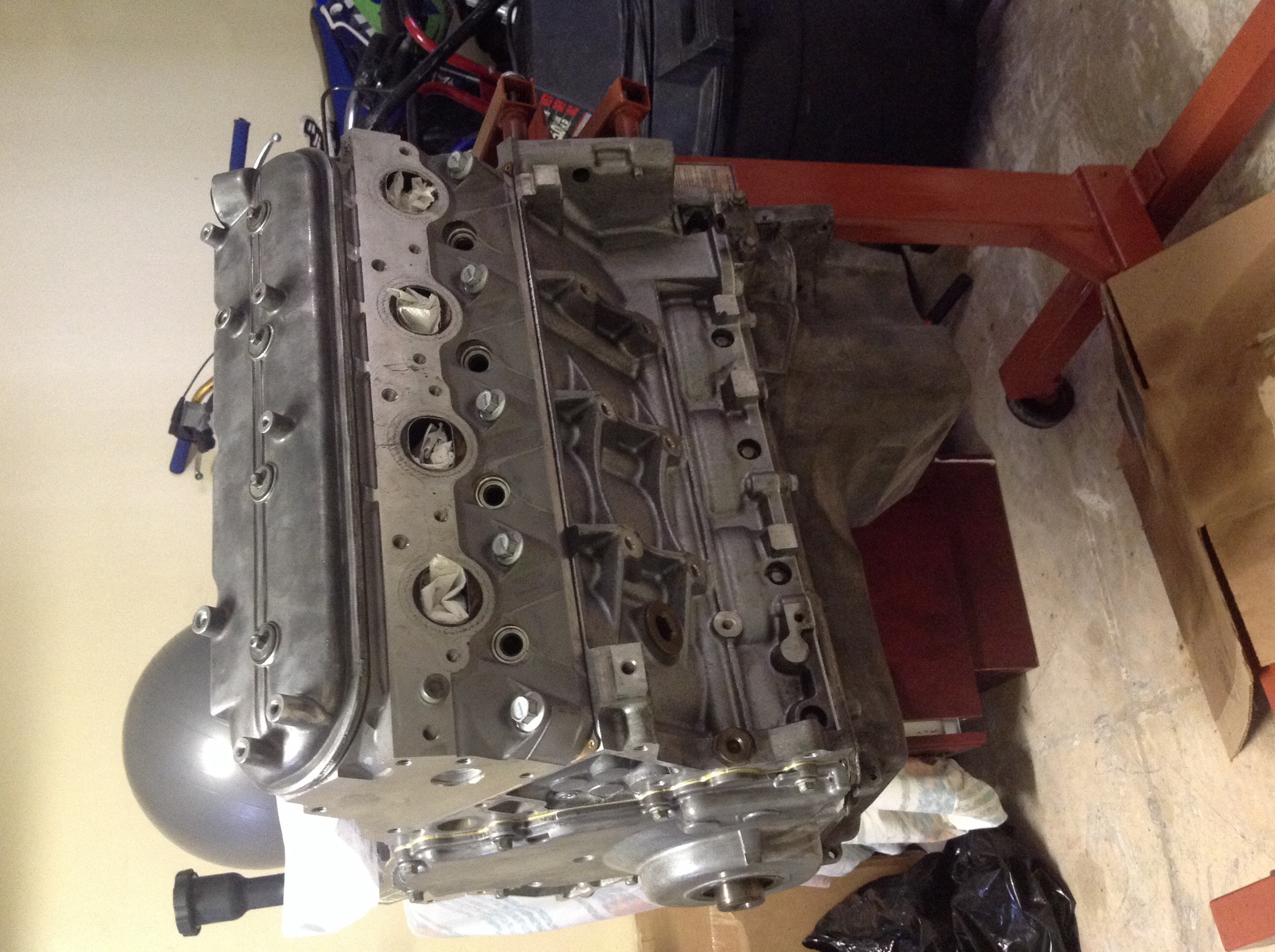

Im very close to dropping a new ls1/6 into my 03 rcsb. Just need a manifold/header, a crank pulley, and to buy a converter.
I've heard that short headers do not provide much gain, if any, over the stock manifolds. I also dont care to spend a bunch of money on headers and exhaust, just to make 15-20 whp. Its not worth the added noise that comes with it. Thats not what this truck is aimed towards. Its not fast, and it never will be. Its a $4500# truck.
Anyway, im pulling a 4.8 and installing a 5.7. I dont want to remove the stock manifolds from the 4.8 because the bolts are known to break. My buddy is getting the 4.8 and its just easier to leave them on.
My plan was to buy a replacement set of oem used headers off craigslist. That has fallen through, cause people charge too much for their garbage. Plus id need hardware and gaskets. When you add up expensive garbage, gaskets, and hardware, well I might as well buy them new from summits since it comes with everything.
And if im going to drop $200 on stock manifolds with gaskets and hardware, i figure maybe i should just get a decent pair of shortys for a little more.
Anyway, what are the best shorty headers, as far as quality, fitment, keeping quiet, and not sacrificing any power? Gains wouldnt hurt either.
