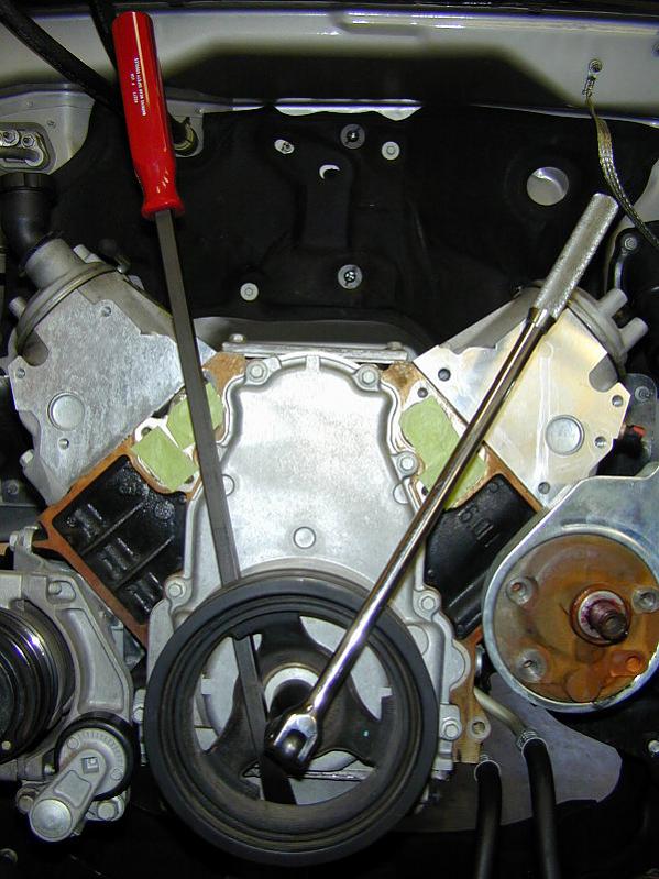

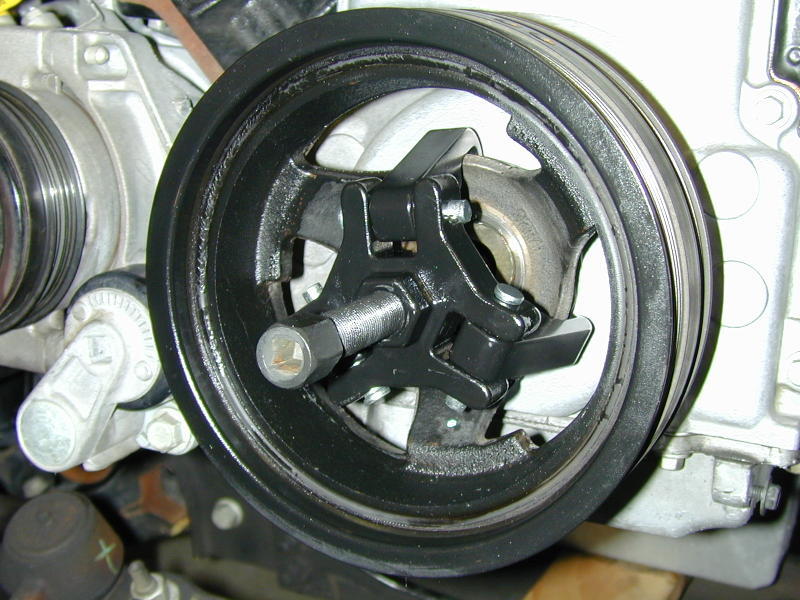

I found these pics in an old thread.
Attached Thumbnails ASP underdrive pulley removal help-pulley1.jpg   ASP underdrive pulley removal help-pulley2.jpg
