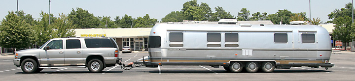

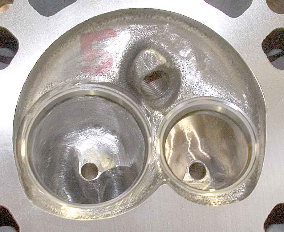

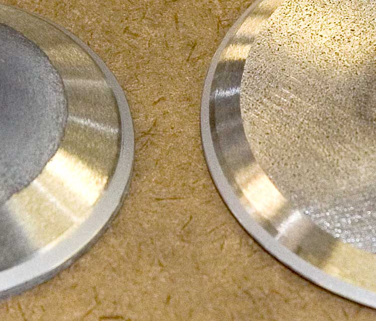

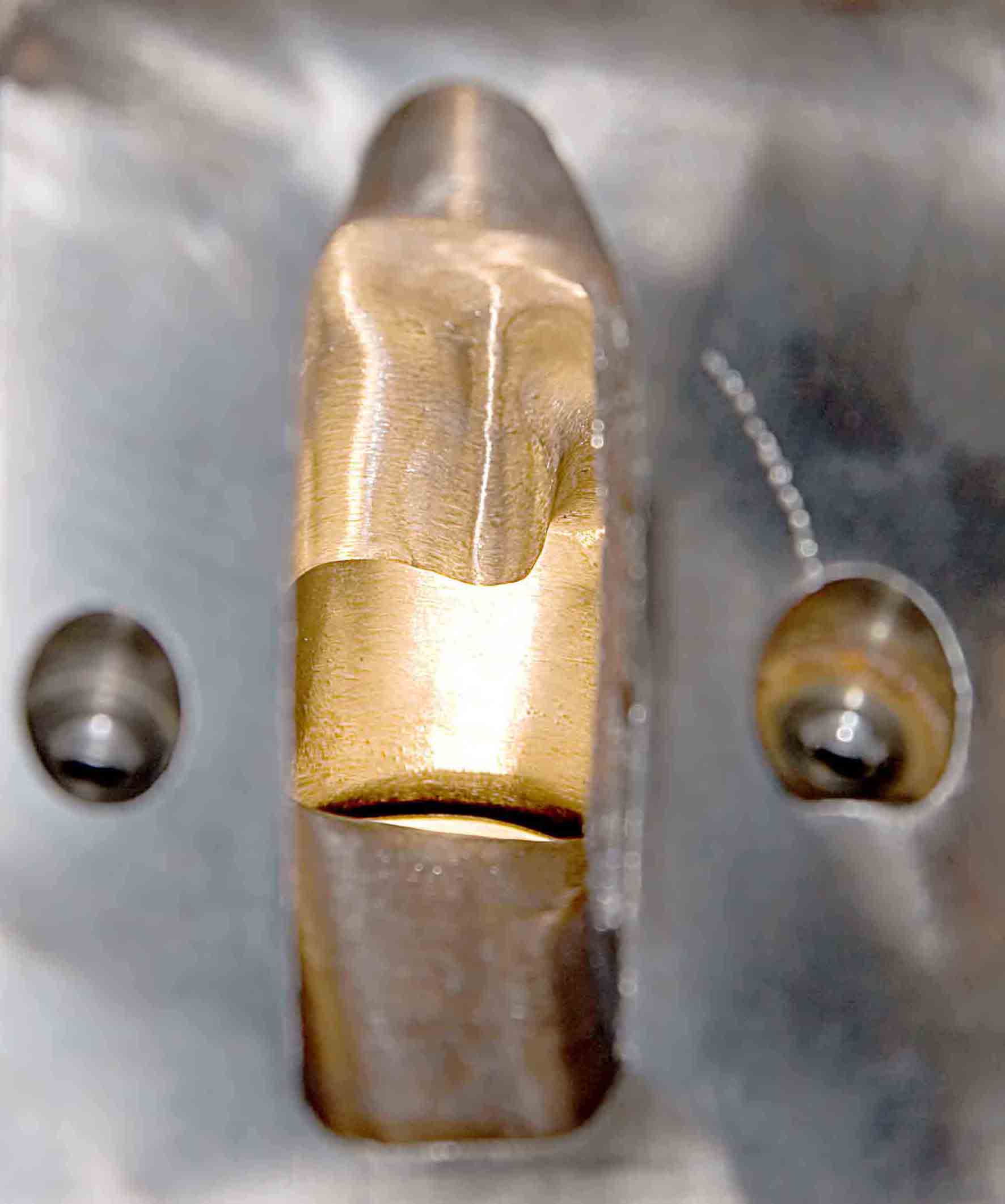

Well, I've gathered up most of my parts to finally get going on this project (Callies DragonSlayer 4.0" stroke crank, CompStar 6.125" Rods and -18 CC Wiseco pistons plus gaskets, etc.). I've got a good seasoned 6.0 L block and I'm going to have the machining done in about November. I've been trying to decide what to do on my heads (keep my hand ported cast iron heads or go to some new design small intake runner heads). I'm looking forward to finishing this project as I've been planning it for about three years.
I'll keep you posted on the project.
Steve
Attached Thumbnails Anyone Stroking a 6.0 L for Towing?-yukon-xl-airstream-small.jpg   Anyone Stroking a 6.0 L for Towing?-combustion-chambers-valve-job.jpg   Anyone Stroking a 6.0 L for Towing?-nearly-finished-intake-port-1-copy.jpg   Anyone Stroking a 6.0 L for Towing?-valves-hand-lapped-backcut-close-up.jpg   Anyone Stroking a 6.0 L for Towing?-valve-seats-close-up-copy.jpg
Last edited by Steve Bryant; Sep 1, 2006 at 07:27 PM. Reason: I've uploaded some images of my Yukon XL with my 1991 Airstream and the head head porting that I did last year.
