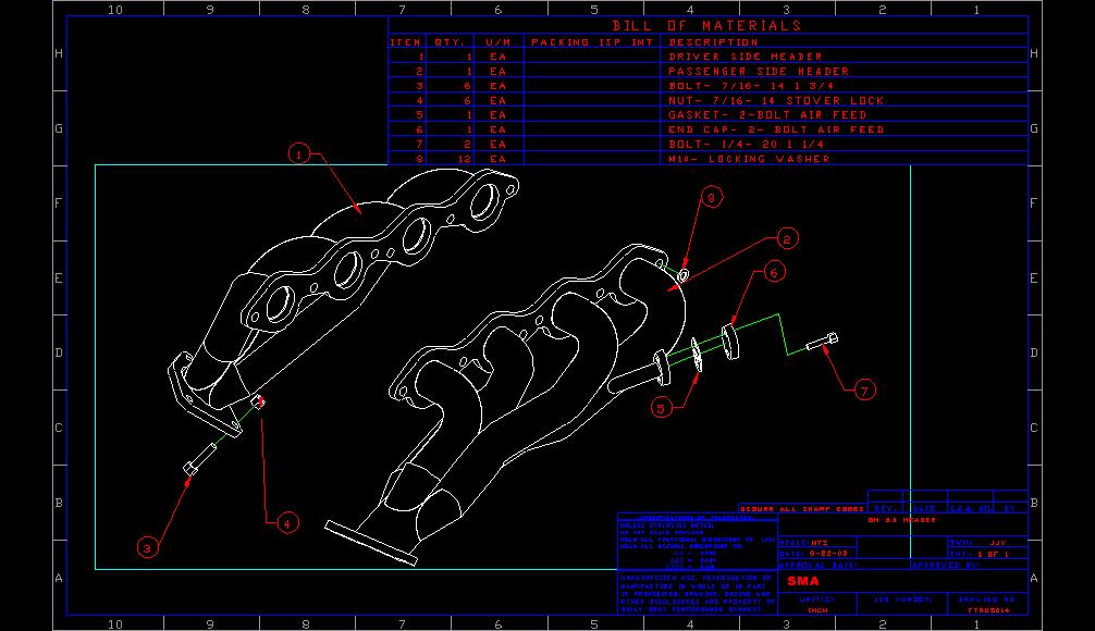

B&B 6.0 shorty headers: 1.75" primaries, 3" collectors. 12-14 rwhp.
Pictures here in this PDF.
They're as short as hell, but I like these specs. Plus the fact that they're stainless. I don't think a ceramic coated steel header will last long at all.

Can anyone here view a .dwg file? (autocad I believe?)
I got one from B&B.
EDIT: Got that sorted out... it's attached.
