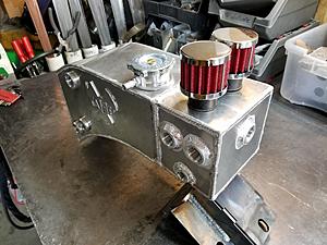

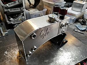

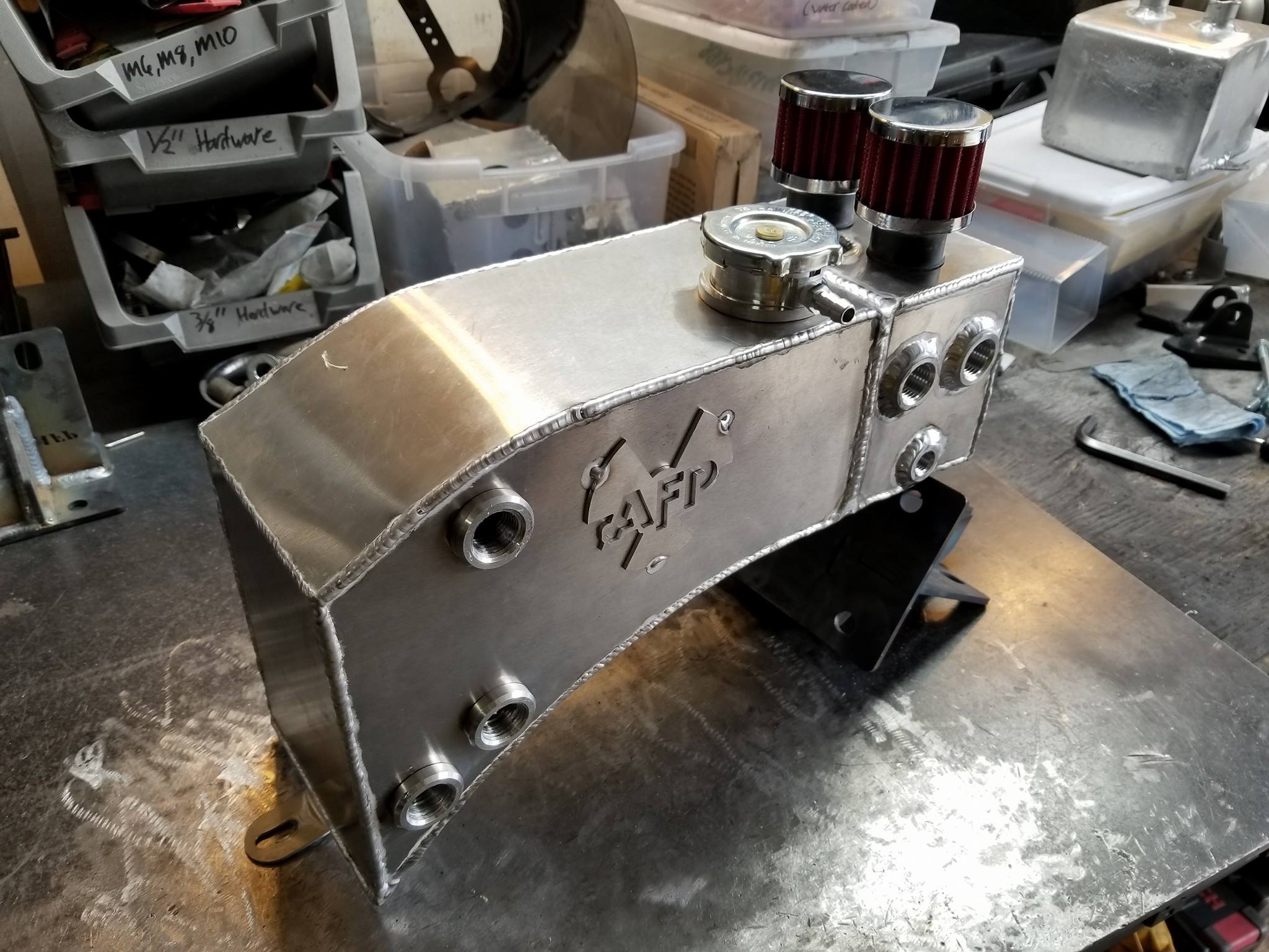

I do the same as Atomic, I run a -10 off both valve covers and a -10 off the valley cover to my catch can my intake gives me alot of room though.
Old Feb 12, 2018 | 10:56 PM
Atomic's Avatar
I have a gauge for that
Posts: 16,282
Likes: 438
Very nice! Your aluminum welding is definitely better than mine.
Here is my combo tank I have made a few of, basically same thing, coolant tank catch/breath can combo. You cant see it, but there are tubes and a plate with a bunch of small holes to act as a baffle inside the breather can.
