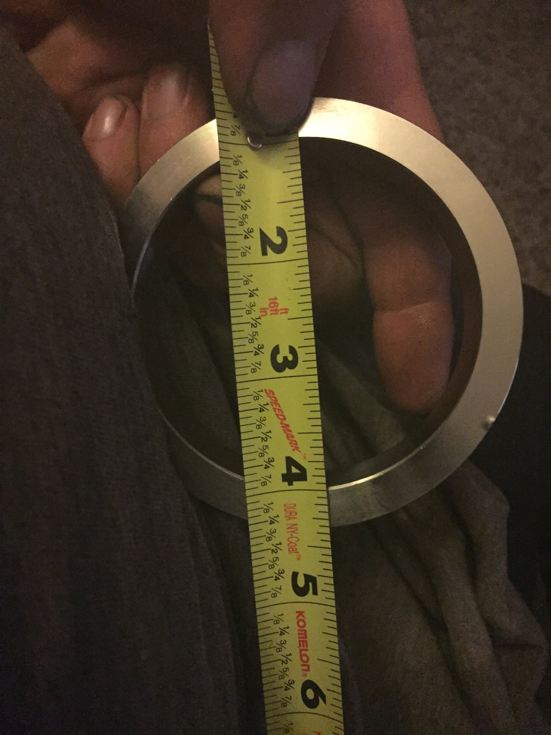

Before i put my v bands on after i cut the excess off etc, etc i am goin to run a pipe expander through my collectors... They measure 2 15/16 OD one direction,90* from that they measure right at 3" may wait til i tack the cbands in place and then run my expander through it.... After looking at these vbands am thinking if i slightly stagger the pipes in the flanges (have 1/4 sticking out past inner face of the flange on the collector and same distance retracted into the flange it may help to seal them better.....
Slight gap between v band flange and collector
V bands measure exactly 3"<br/><br/>I know not proper tool but its closest i could find at house at moment
