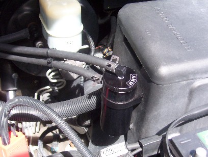

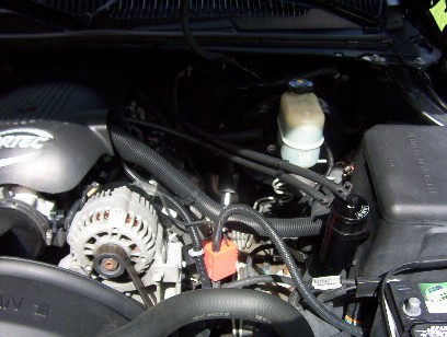

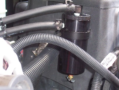

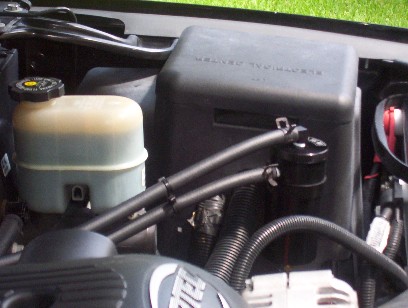

I just removed the fender bracket on the drivers side and removed the plastic housing of the fuse box after marking a line for the bracket to be mounted at. I then drilled my two holes and went back to double check the clearance with the wire bundles under the fuse panel. Everything looked good so I went a head and finished mounting it all. I also wrapped a little electrical tape around the open tips of the screws to keep any wires from rubbing on them and causing a short. I never saw anyway the wires would hit the screws, but it was a, just in case, type thing. Later on I'll put some rubber tips over them or something that should work better than the tape.
After putting the housing back around the fuse box I made sure I had enough hose and finished routing the hoses which left me with about 6 inches left over. I could have used a little more slack in mine, but I wanted to make sure they wouldn't move around and touch anything hot while driving.
Check back around noon or 1:00 today for pictures...

Here are some pictures after I drove it for a while, so it's a little dirty.
