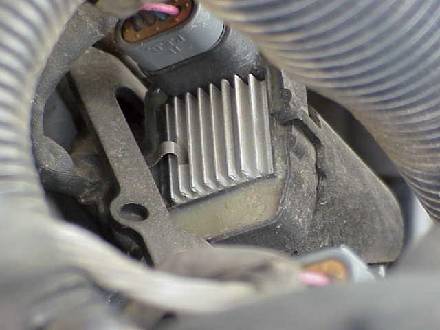

Got a picture?

If you go to the AC Delco website http://www.acdelco.com and go to the parts section, you will see a picture of the Delphi coil ( AC part number D585). This one has the heat sinks. Unfortunately, they do not have a picture of the Mitsubishi coil.

Here are pics of both.
Attached Thumbnails Are all truck coils the same??-mitsubishi-coil-no-sink.jpg   Are all truck coils the same??-delphi-coil-sink.jpg
