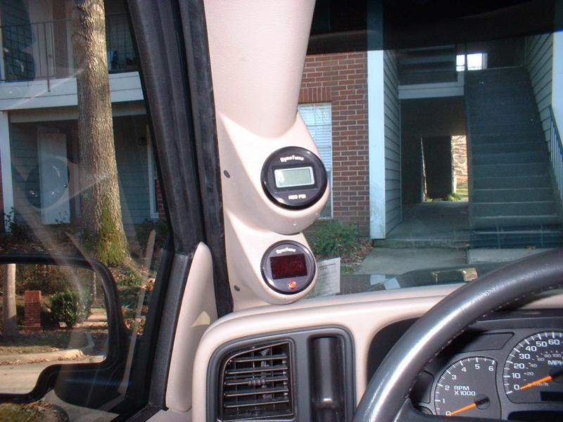

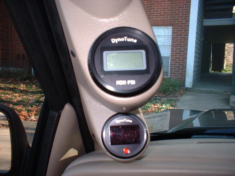

I have a Air/Fuel gauge but it reads in millivolts. I always read were people said that they were pointless and way off and compared to a wideband yeah they arent as accurate but they arent pointless. I wouldnt buy one of the Christmas tree ones but I liek the one I have. The closer you get to WOT the more accurate they are and thats all I need it for is at WOT when spraying since my n02 doesnt activate untill WOT. Here is the one I have
http://www.speedshop.org/store/Scrip...p?idproduct=15
Attached Thumbnails air/fuel gauge; are they worth a crap?-gauge1.jpg   air/fuel gauge; are they worth a crap?-gauge2.jpg
