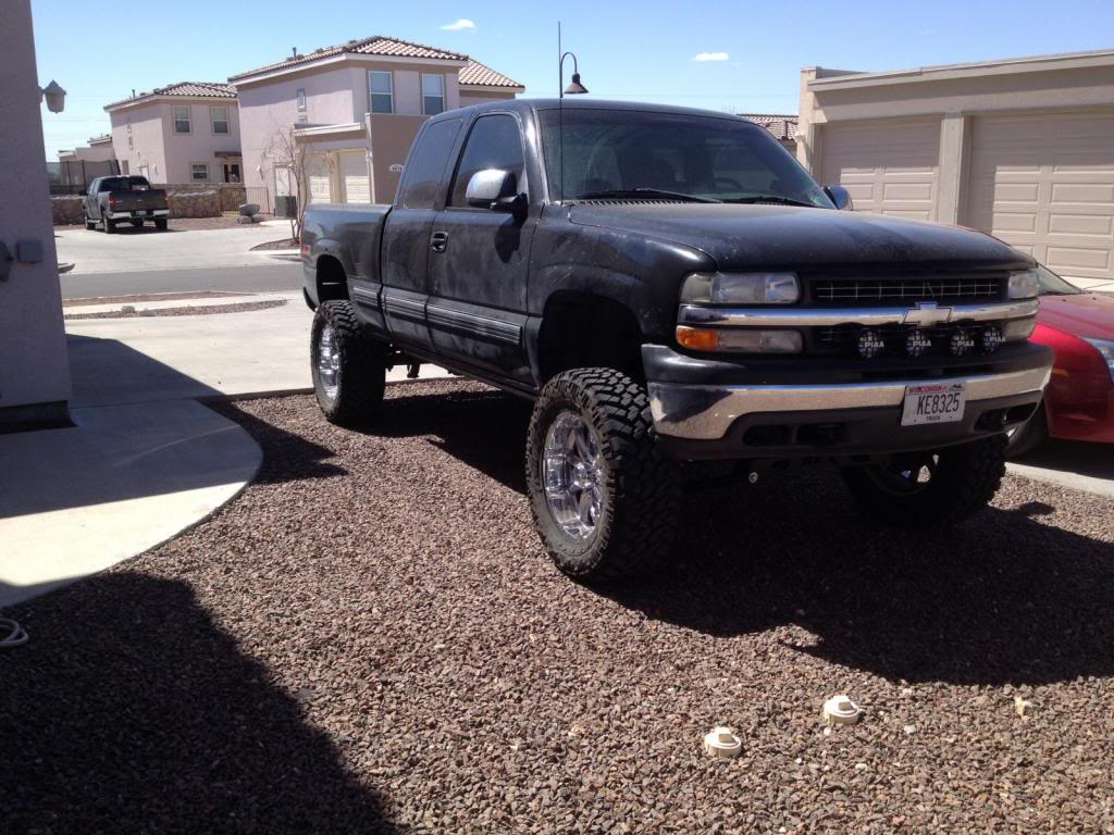

Yup!!! 213000 now. I run full AMSOIL synthetics. I know it's a lot of miles, I plan on building a 395 stoker after this next deployment this winter, so i will use the cam in there also. And not to worried if i blow up this engine, as i have a plan in place already to replace it and have a bike to ride during the build. Not that I have the money to build it now I just want the power.
Thanks for the link never thought about that step I thought u ment puller
A bit dirty but it's nice to have power in the sand
