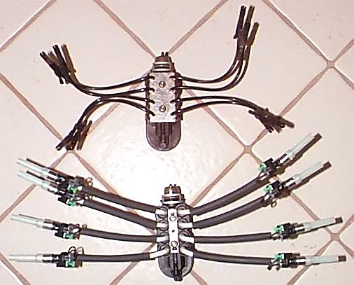

This article discusses it
CSFI to MPFI - Vortec Engine Fueling Fix - Fuel Injection - Off-Road Magazine
As does this GM document
http://www.acdelcotechconnect.com/pd...sb_05D-105.pdf
CSFI top, MPFI bottom
If you peer down the throttlebody, sometimes you can tell by which hoses are present. The MPFI have thicker spider arms, while teh CSFI are thinner.
Both spiders flow 23.1 lb/hr The MPFI spider use actual Multec 2 mini-injectors at the end of teh spiders arm, rather than simple poppet valves like teh CSFI setup does. IIRC in 2004 the 4.3 in teh FS trucks went to the MPFI in stock OEM applications.
