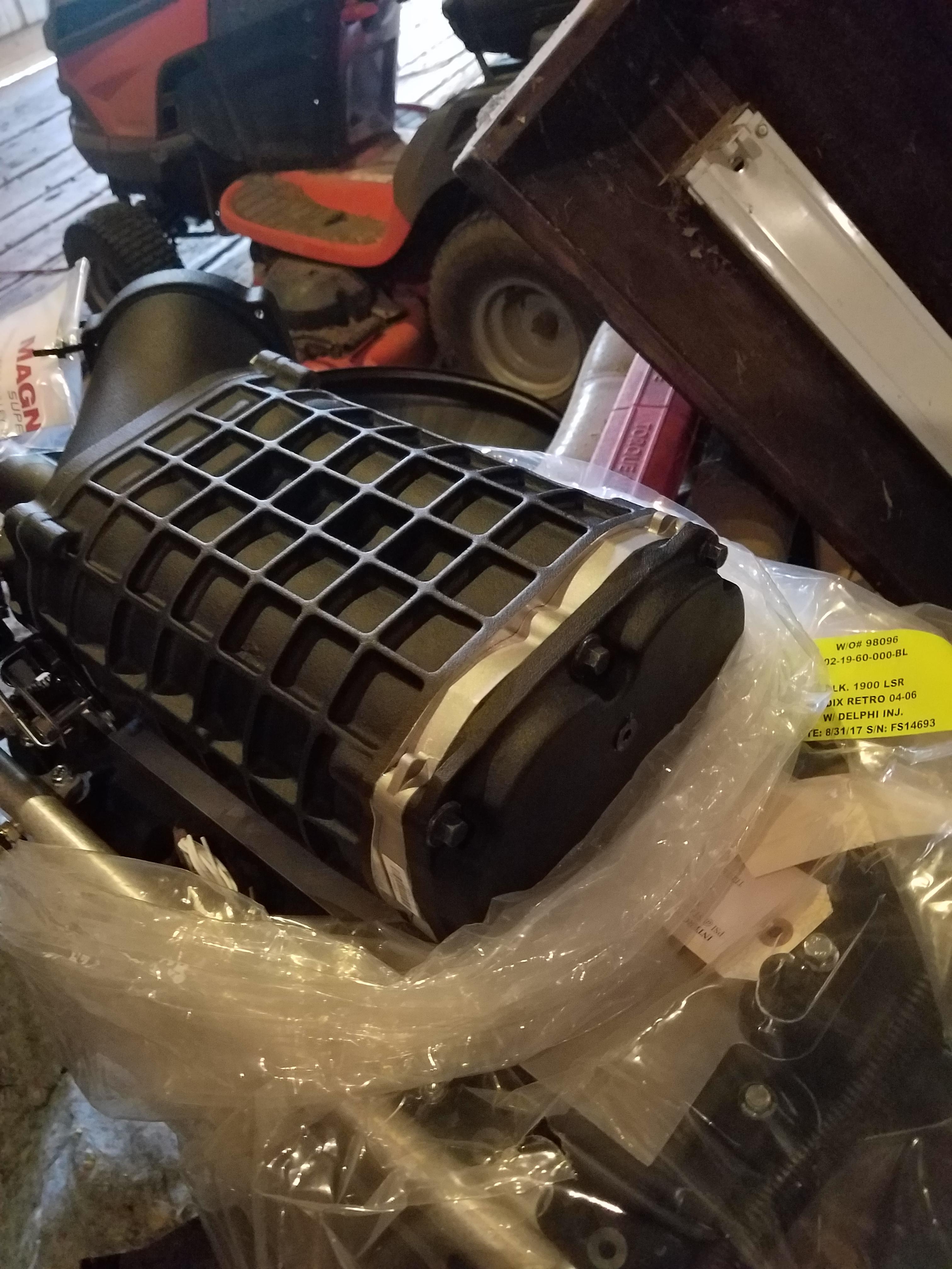

This just came today!

The 2300 blower comes with 60 pph injectors and not 42s like the 1900 does. Otherwise it's all the same kit for a gmt800 truck. I sold my fuel pump to a buddy... going single 450 to start... and I bought the heavy duty tensioner over what the kit supplies. In all reality I won't probably use much of the kit.. but then I'm not a stock 6 liter either. A buddy of mine sold his whole setup to a guy and he put it on his cam only 2000 5.3 truck. Added a tvs 1900 and long tubes and it made around 511 whp in a 2wd 1/2 ton... I think he ran the 3 inch pulley on the blower. The 1900 makes good power.. and if you aren't doing internals especially you may as well just run it.

I think that used to be the case but when contactes them they said the 1900 and the 2300 both come with 42lb injectors.

Probably talked to someone who doesn't know what they are talking about. I got my kit in December of 2016 so it's not even a year old and I doubt anything has changed. Be pointless to sell the larger supercharger and leave the same injectors as the smaller one anyway.

My 2300 came with 42 lb injectiors. I bought it about 5 months ago

I was told the same thing by SCOL and Magnuson. Only the jackshaft and some gto kits get 60lb injectors.
