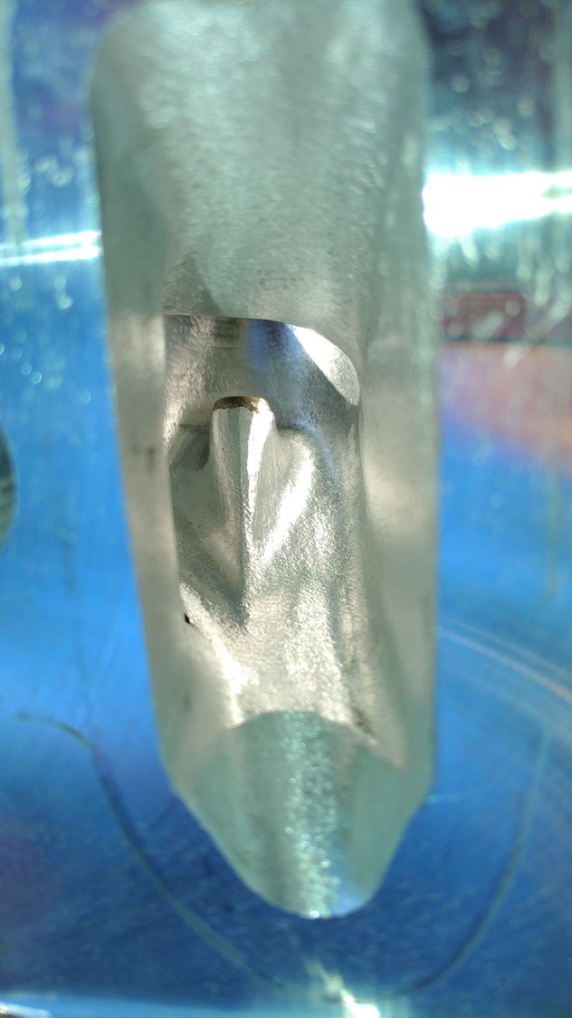

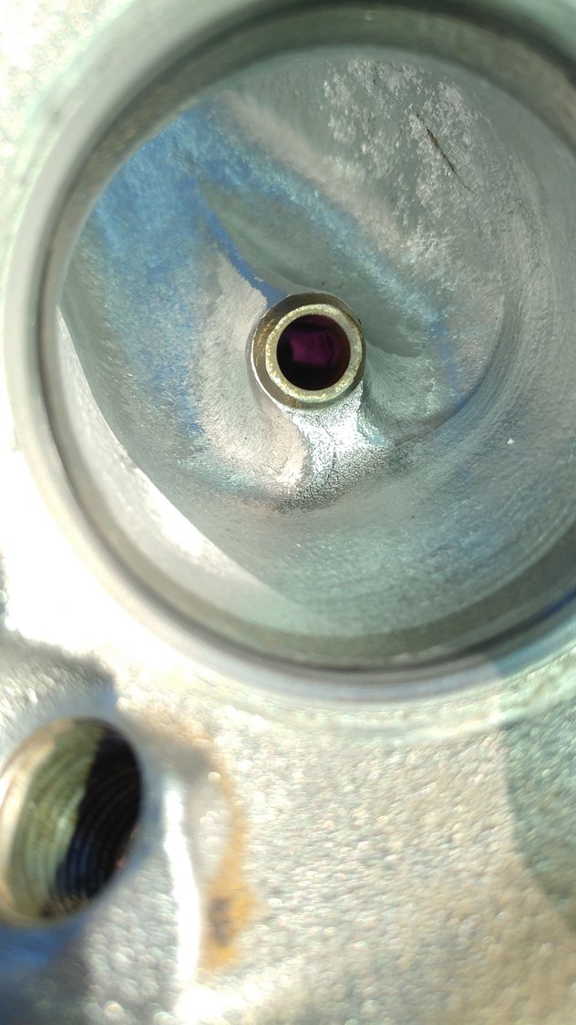

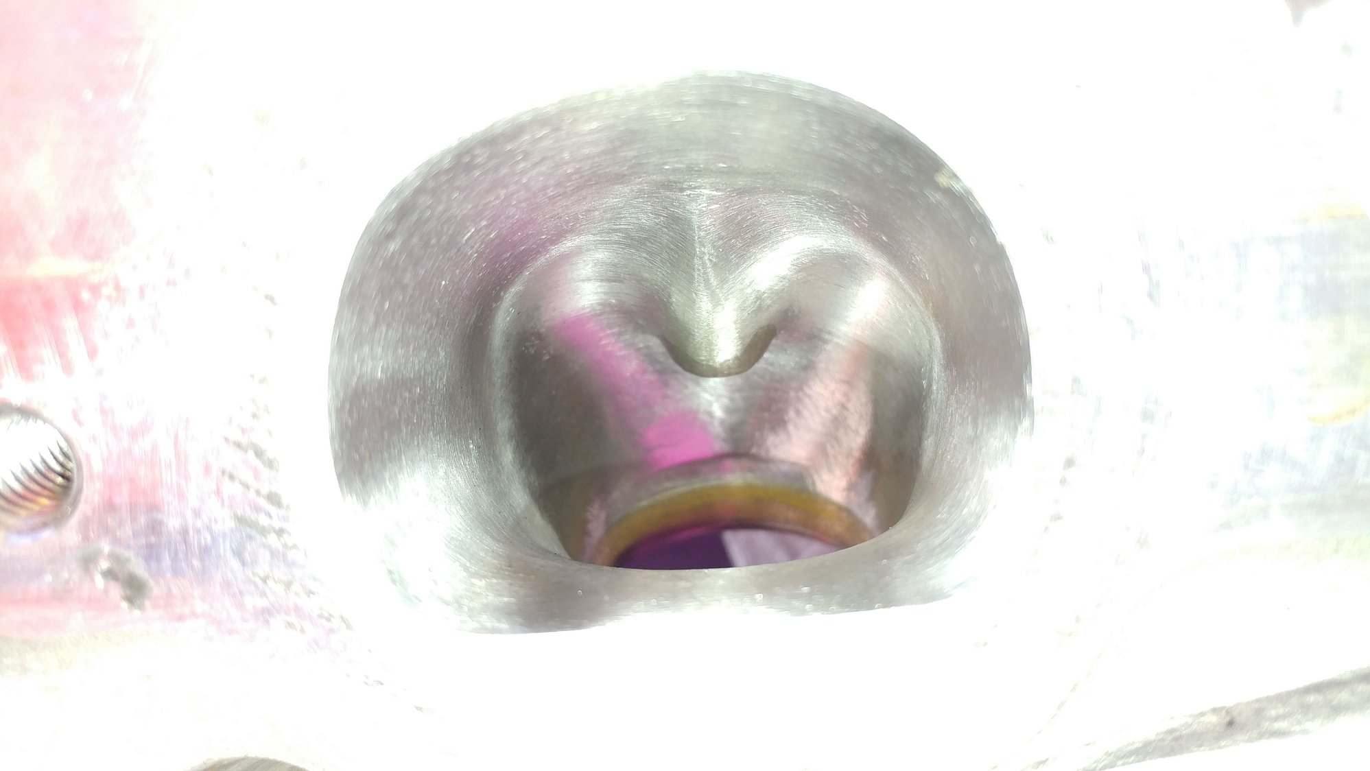

no but I can ask the porter. I don't think much but I can post a pic of them. Maybe you could tell idk

those do look pretty but im talking about the chamber where the combustion happens. basically the area where the sparkplug is.
in the first pic it from what i can tell it still is the stock casting there as it is still ruff like it is. if that is the case then it should be ~64.5-65cc chambers. best way is to lay some grease lightly around the chamber, put a sparkplug and valves in, and a small piece of plexi or glass over it. count how many cc of water fills up that area. CC=ml
if it is just stock then look for a build with around a 18cc dished piston to keep the compression around 10.3:1 and you can run premium gas only.

oh ok well yea that hasn't been touched. I'm new to all of this only know the basics thank you for helping and explaining. That's great I only run 93 in my truck anyway.
