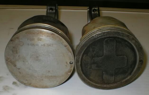

What do they look like? They have like a cross? I know they're dished, now I did the spark plug and wire to find out what motor I had and it's smooth I even put a little light. It's a 4.8 right id be able to feel bumps if it was a 5.3

It was a Little light from snap on and its flexible, like a snake light. I don't wanna take off the heads :/ its the dishes 6.0 pistons that have the cross?

yea a slight cross https://ls1tech.com/forums/parts-cla...317-heads.html

And it would look obvious and I would feel it right?
What year are you dealing with?
The pistons on the right should be the 5.3 pistons with the little cross and a dished lip on the edge.
I told you how to do it without taking the heads off.
Take a spark plug out of the head and scrape a drinking straw across the piston deck. its super easy and wont cause any harm. DO IT
Lol i did it! and yeah its a flat top, but i was just making sure
