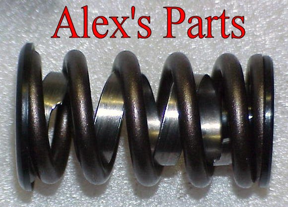

Here's what mine look like, with the flat inner spring. I haven't seen much of this style in my searches:
Is it just me or is that inner spring busted up too?

Typical old school small block chevy stuff here, it's just a single spring with a dampner.
Measure your total valve lift off of the top of one of the good retainers, (I doubt it'll be much more than about .500" lift), and get a complete new set of springs, retainers, locks, and seals good for a little more... say .550". It's always better and cheaper to do it right the first time than do it over the second, and maybe cost you an engine in the meantime.
I would doubt that the rockers would would be hurt, but I'd look'em over real close. You could also have a machine shop check the pressure on your old springs to help you get more in the ballpark, but unless you've got a billy-bad-azz radical cam it doesn't take much of a spring to spin a sbc to 6K or better.
Hope this helps.
