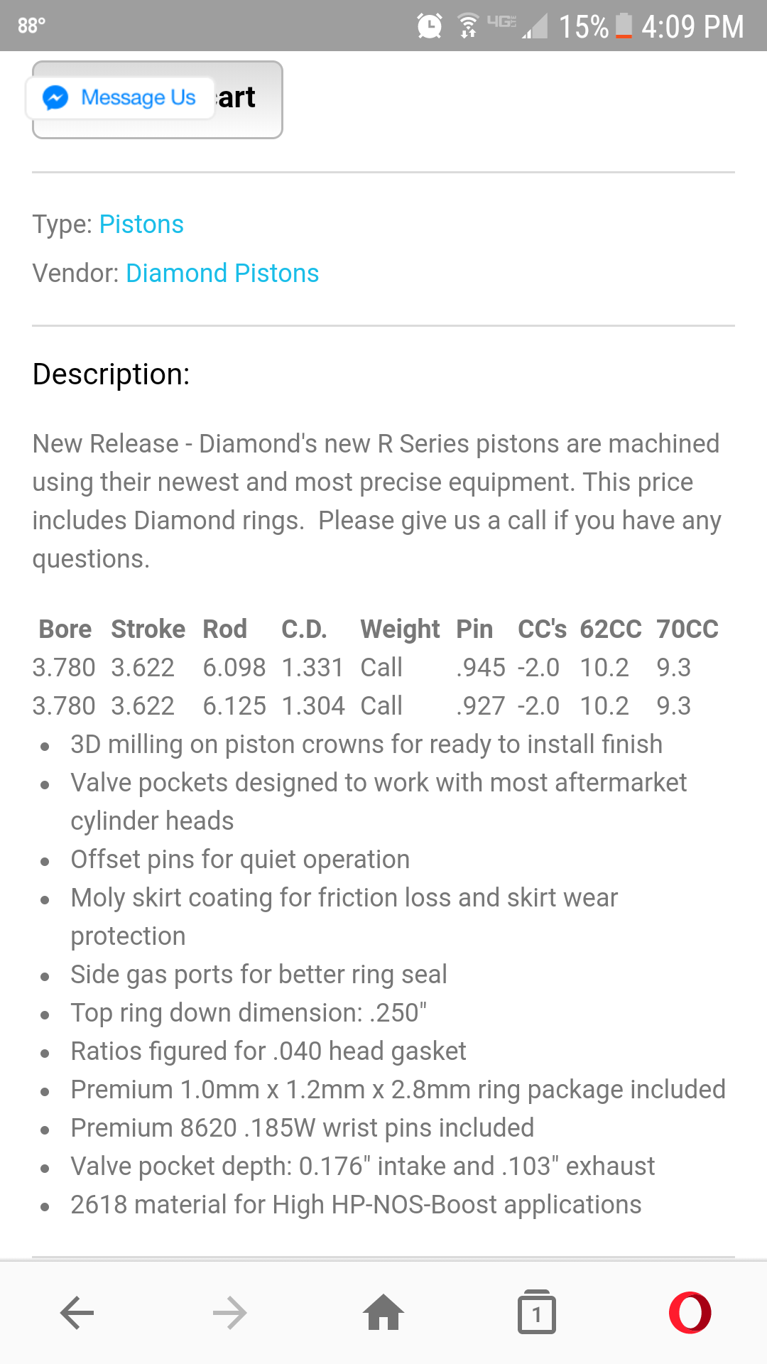

Any one try the 3.780 diamond pistons yet? Look pretty good. Just curious how they compare to wiesco.

I don't run this exact set but run Diamonds in my current Stroker and couldn't be happier with them. Wiseco bought them out just over a year ago and their prices shot up. Good choice, though, in my experience.

Any on know what material the wiesco's are made of?

And on a side note, i found a place that has there for 670 free shipping. So that's 100'ish less than I can find the wirscos
