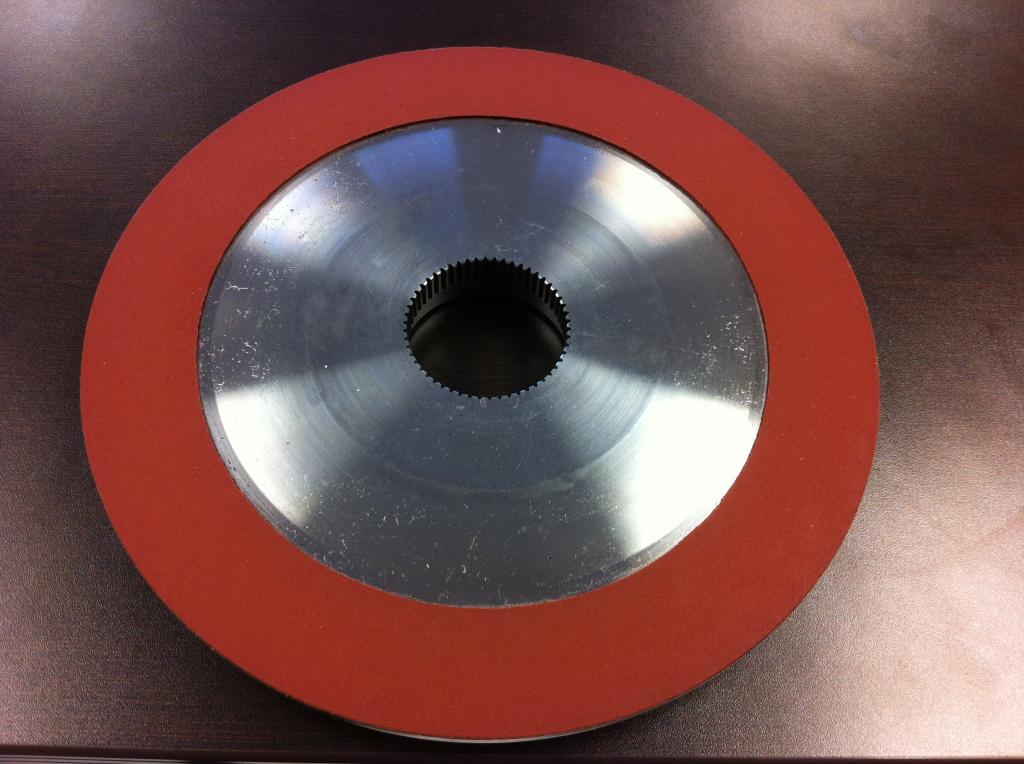

Originally Posted by trxmxzx
So was this considered a billet single? I'm only asking for my own knowledge and I'm looking at a triple disk from circle d - I'm going off the " you get what you pay for" term people speak of
That is definately a stamped (not billet) lockup clutch disc.
This is what a billet piece (single disc) would look like.
Friction side:

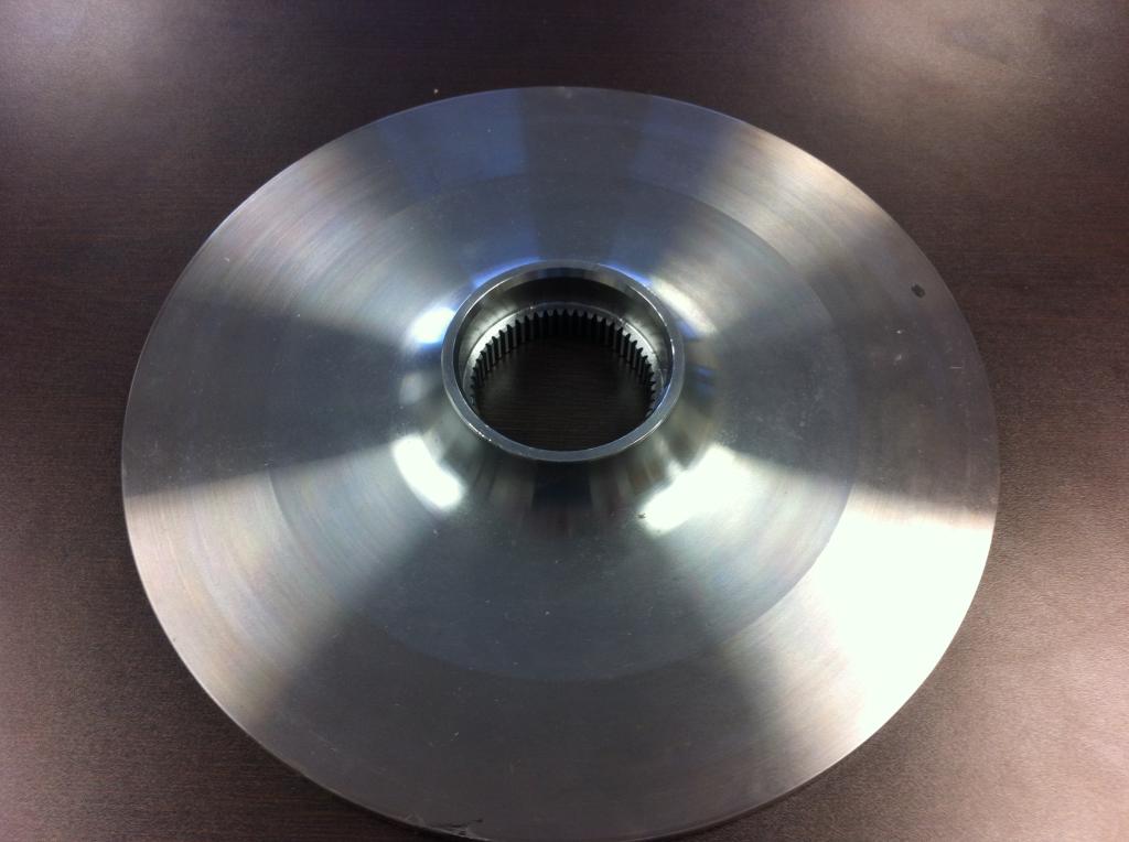

Back side:
