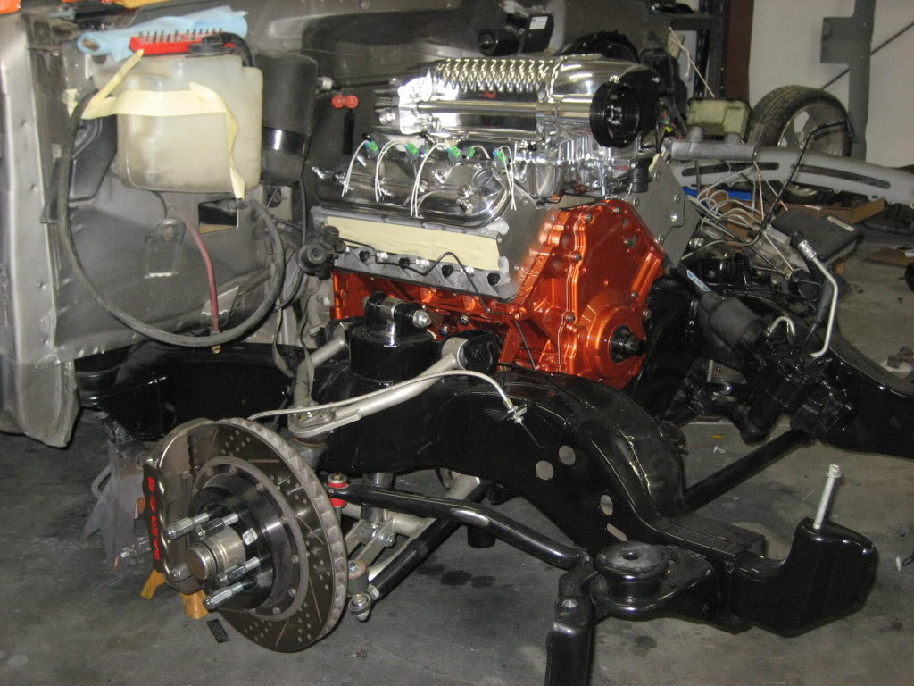

I have L92's with west coast racing heads stage 2 port job on my lq9 with 8lbs and it could use just a little more at the bottom but it runs like a **** up top it all depends what you are going forName:  011.jpg
