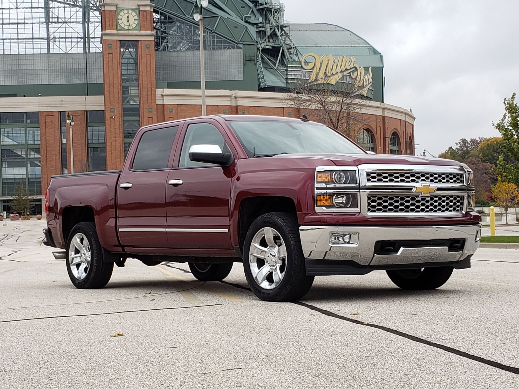

I have a 2014 CCSB with the 6.2 and similar bolt-ons as you. Just finished putting a nitrous kit on it and love it. Next step for me is probably a cam but am really happy with it right now. Truck is full weight right now and I just ran a 12.74 in it. Only difference is I'm running e85. Makes for a hell of a sleeper.
