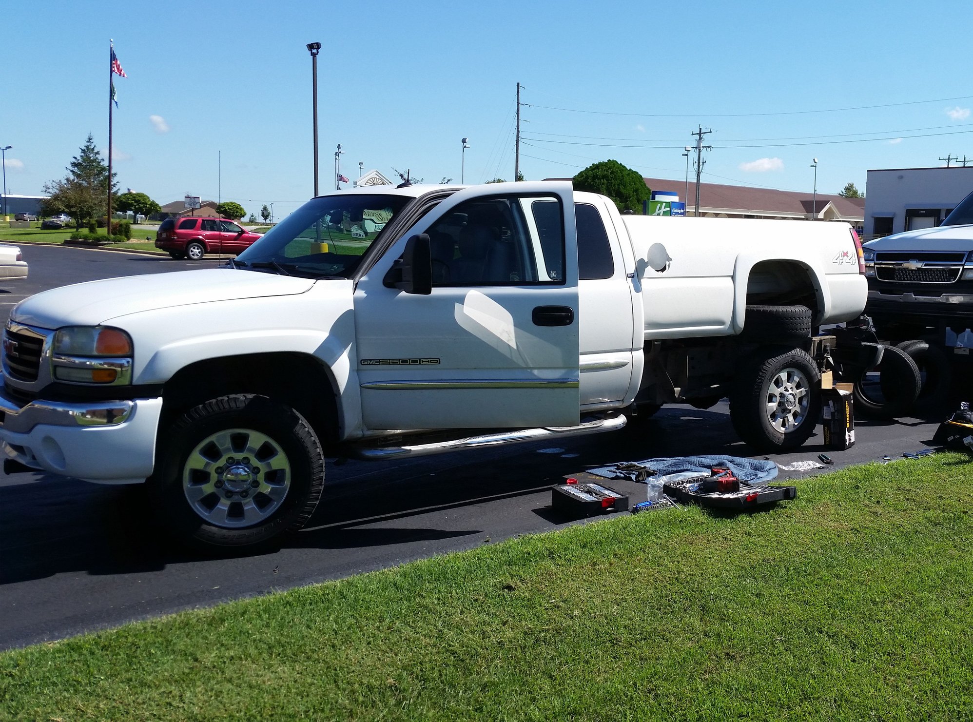

You mean like this when the 36 gallon tank is 3/4 full and your in the middle of no where with a loaded trailer???
As long as you don't buy a crappy one you won't have to do the job twice...
