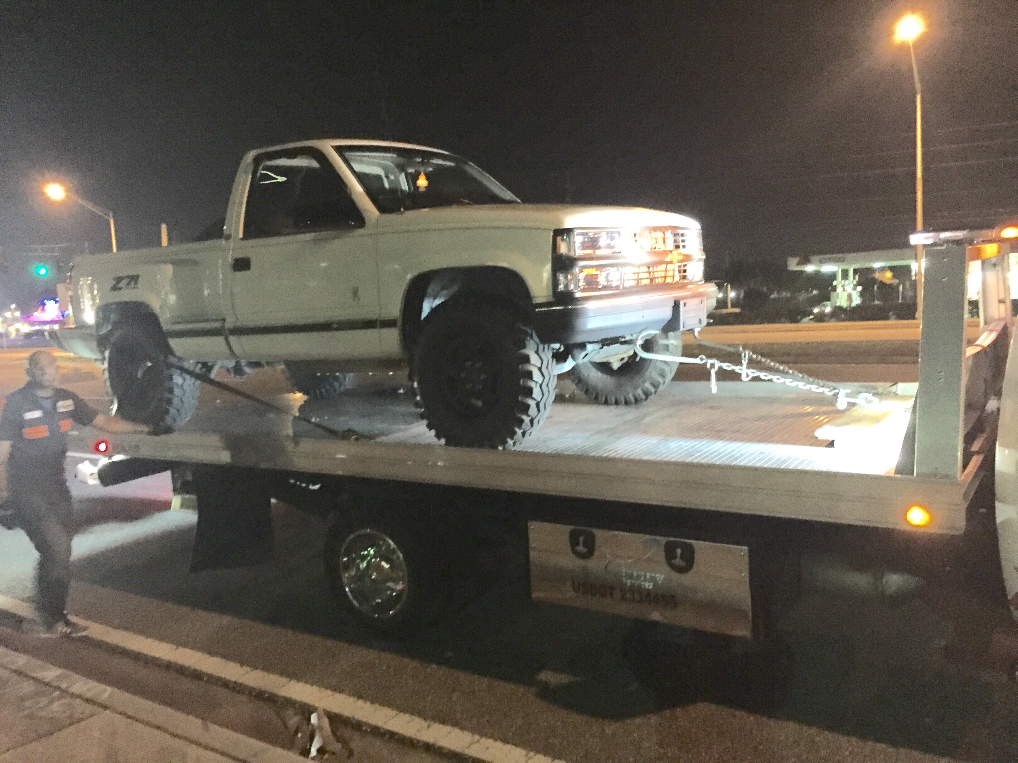

Well, looks like I'll be picking up a 14 bolt too. Did the first clutch dump last night and bam...broken rearend. I haven't popped it open yet but I'm guessing it's the g80 limited slip. The yard that I got the motor from has a semi floating 6 lug 14 bolt with limited slip and 3.73 gears that I'll prob pick up.
