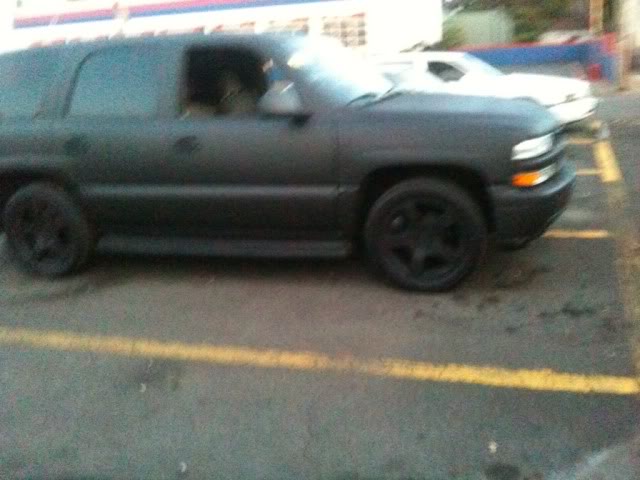

it is very possible. Im working on being low 12s in mine, possibly 11s. It will take some money though. you will need every bolt on possible, with the addition of FI.
this is what Ive done to my tahoe so far.
votec max 6.0
227/235 cam
6.2 heads & intake
LPP long tubes, CAI Airaid
3200 stall
4l80e built
3.73s with 30" tires
lowered 2/4 with weight reduction
PLUS a turbo kit is going on it this summer. then Ill be low 12s for sure.
Once I put a stage 5 on it, Ill let you know.
