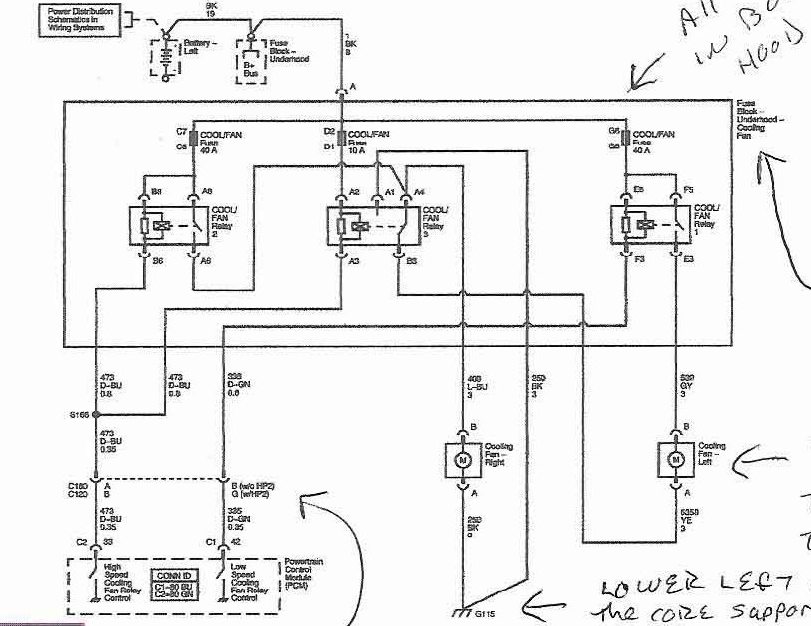

Took some cropping to get file size down and it still be legible, but here ya go...PM me if you need a copy of this or a schematic of mine for either harness......
From an 05 Silvy....

Now the real question.....
Does the pin 33 work on the 03-04 PCM's ????
Guess I can go out test that for you tonight.... It does in the 05... It is just the opposite connector than the Pin 42... I will also pull my helms manual and see what the ECM pinout says .......

Originally Posted by BigBlackAv
working on that too...hope to know for sure next early week!
all done...and yes it does ... w/ HP Tuners you have to have "2 fans" enabled (not "aux fans") but in my '03 Av pin33 works, it was blank, I added a new wire and wammo a second level of control from the pcm. I did some testing w/ the a/c (before the engine warmed up) and the a/c head pressure did not make either pin work. I will be wiring a 4th relay to ground the blue wire (pin 42) when the A/C comes on.
